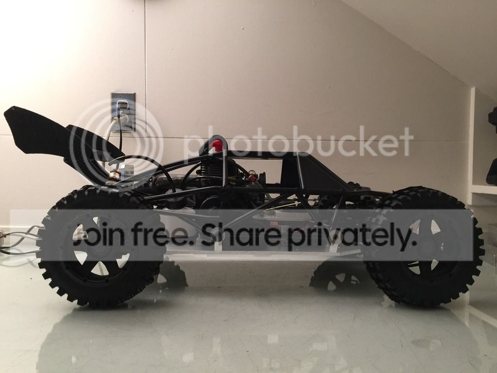

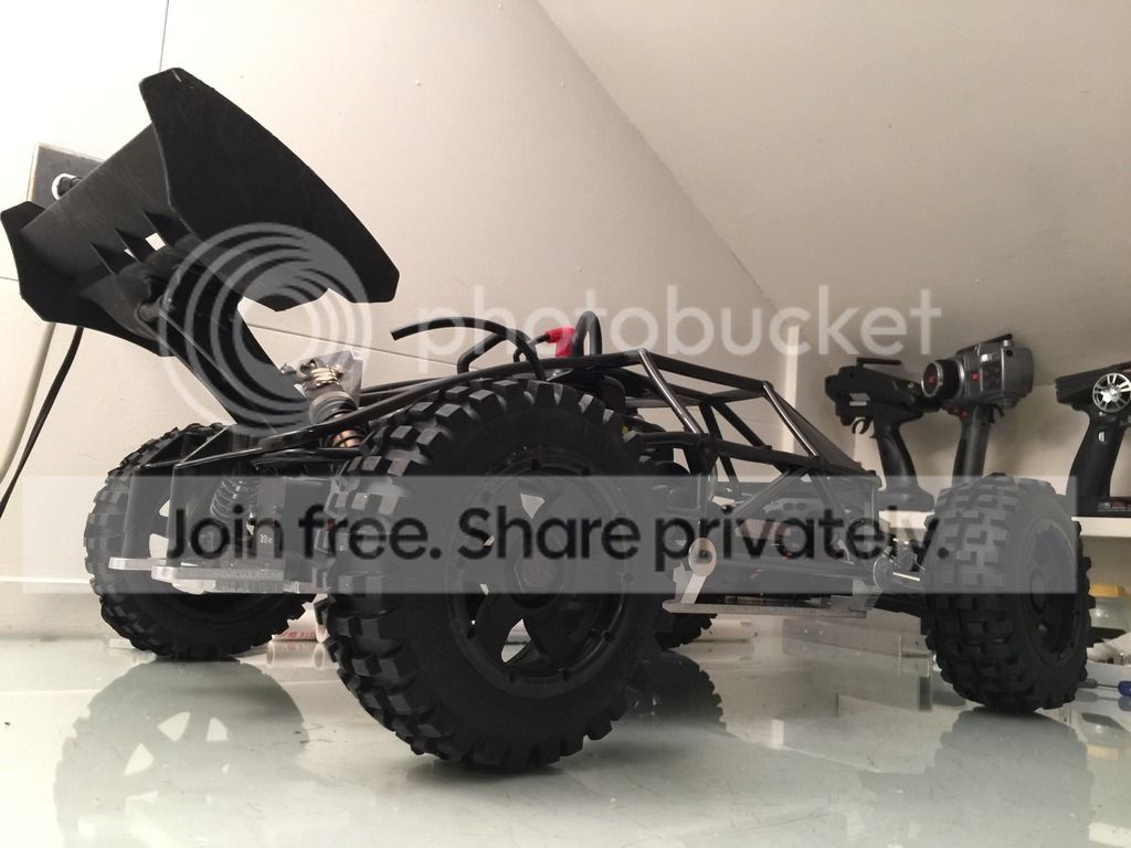

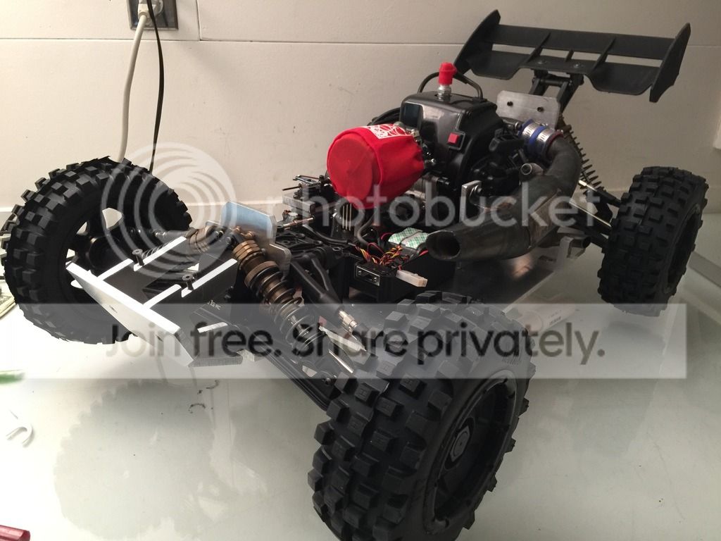

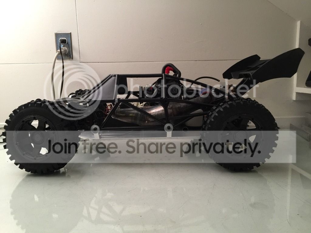

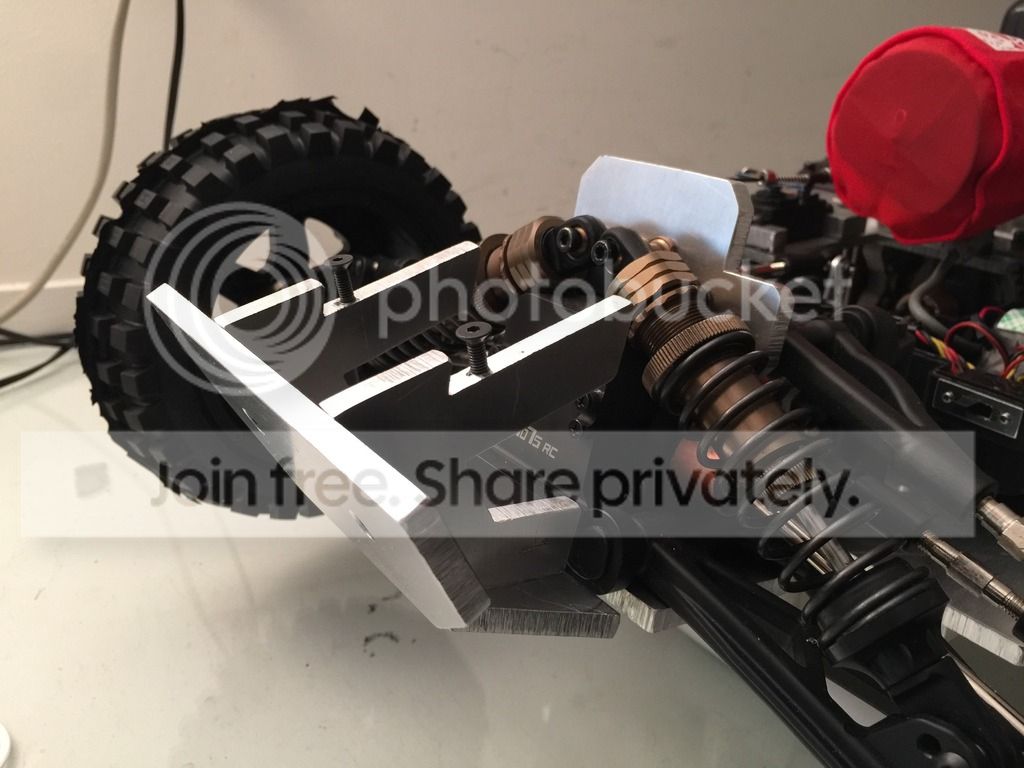

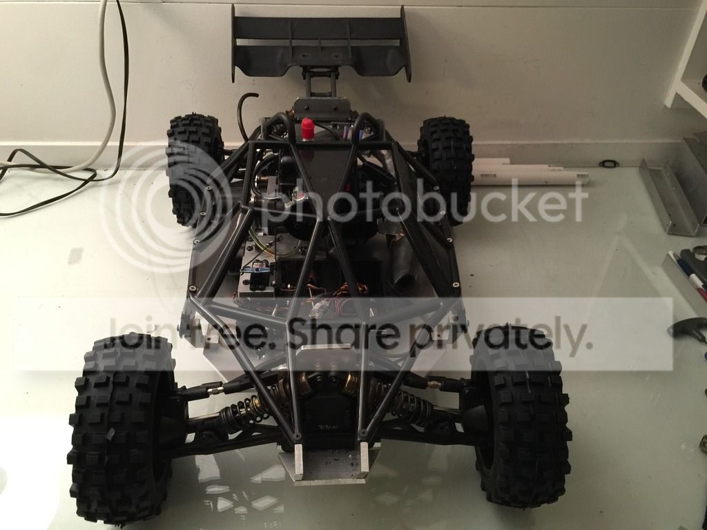

I was able to achieve an optimum suspension output using thicker shock oil and a little preload on the spring. I always use thicker oil anyway. Plus with the chassis being low only 2-2.5" of suspension travel is need. I have 2.5" usable inches and 1.5 more unusable (chassis bottom out at 2.5'). I have also limited the down travel so it's flat and low to the ground.XbFreak said:How well do the shocks work being laid out like that? Do you need a stiffer spring?
Hopefully! Unfortunately there is now more snow on the ground than desired to try it. Oh well, I still need to make the chassis under and side tray to keep dirt, stones and snow out. After that done.XbFreak said:That's going to be sweet when its done
