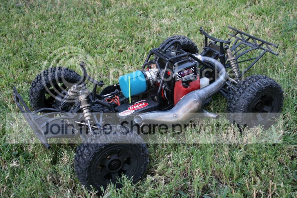

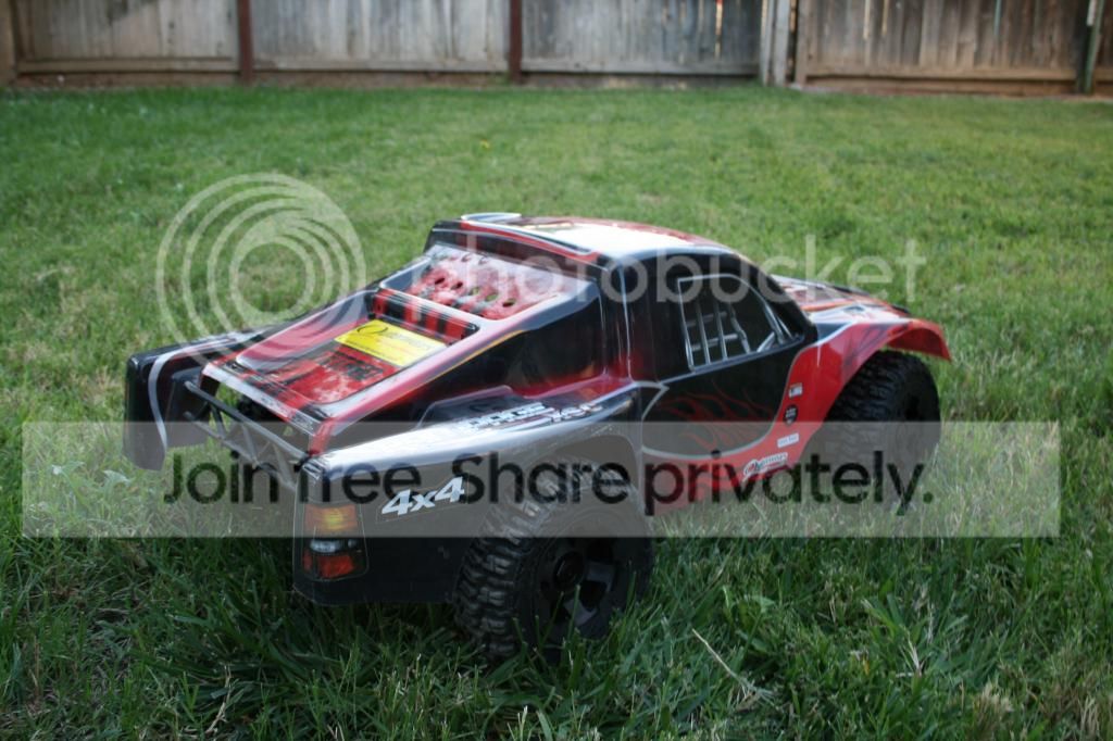

Picked up an XSC with no body, and no compression for $100
Tore it apart, put a new top end on it, found the battery was bad, wheel bearings toast, throttle servo fried...
Turnigy High Voltage Throttle Servo See Link here
Turnigy High Voltage Steering Servo
See link here for steering servo
GBE filter set up (2 stage)GBE filter link
DDm Velocity Stack stack url
Walbo 997 Carb [ame=http://www.amazon.com/Walbro-Carburetor-WT997-King-Motor/dp/B00FT68PD4]walbro 997[/ame]
ada Billet aluminum intake manifold ada billet manifold
Jet Pro Side pipe on it JetPro exhaust
5000mah 5 cell Venon pack battery pack link
Outerwears for pull start and block (local hobby shop)
Fast Eddy wheel bearing kit wheel bearings
Also installed a 3 port fuel grommett set up with breather as I noticed my tank was not venting well at times...
Car runs great now!
