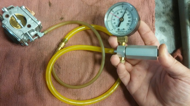

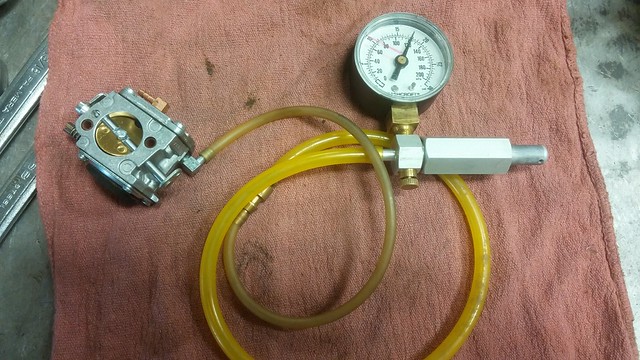

Here are a couple of pics of the metering needle pump that @lorraine is talking about.
[url=https://flic.kr/p/TfNyQU]Metering needle pump by TDC, on Flickr[/URL]
[url=https://flic.kr/p/TfNyFq]Metering needle pump2 by TDC, on Flickr[/URL]
The gauge on mine has a 30psi limit. The carb I tested is a Tillotson from a demo saw. The metering diaphragm hooks on to the lever so it would never pop with the pump. If air made it by the needle the diaphragm would close the passage. I didn't want to fatigue my right hand (gonna need it healthy for later tonight) so I hooked up my leak down tester just to demonstrate whats happening. Of course the air compressor is keeping the needle open for a long duration. The pop and close would be instant with the hand pump.
This has to be the best write-up with pics that I have ever seen. This guy explains it so well, a cave man could understand it.
