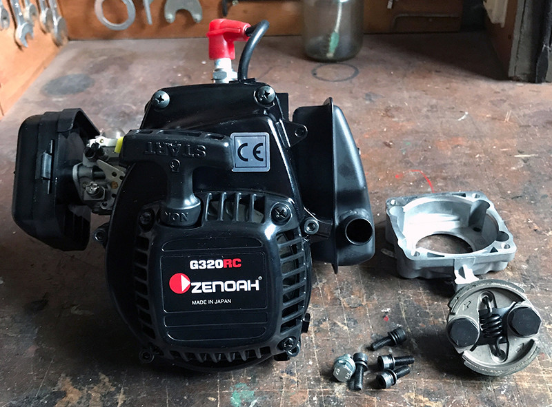

My Zenoah G320 has arrived. :)
My Rampage MT is eager to try it. :smuggrin:

Does anyone know if the original HY 32CC clutch housing fits into Zenoah G320RC?
It does not fit. The g320 uses bigger crank bearings. So everything you order for that engine make sure it states for g320 specifically. Even the intake is different. So if you wanted a billet intake a HY wont work.
