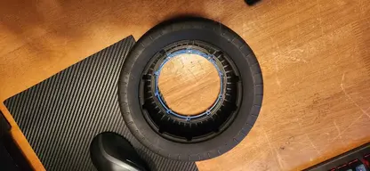

Maybe silicone spray would do the trick?I would not use oil on rubber because it will cause the rubber to distort and swell. Bad idea. Use dielectric grease or some non petroleum based lubricant to lubricate a tire bead.
I thought you said vag oil when I first read it.Thought of maybe veg oil or baby type oil. Maybe the dry lock graphite stuff.
