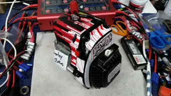

Well the Signature Series OBR g340 arrived. To My surprise there isn't a TR clutch housing on it. No option in the drop-down for it either. Oh well I have one already, will be fine. Now this MTXL should rip well
Now you talking :p(y):cool: very nice ......when did you order if yo don't mind me asking? Placed an order 10 days ago......... still waiting.....:unsure: anyway it will come
It took about 2 weeks to arrive. I got it during the black Friday sale
Love the new wrap they stick on....:love:....wonder if they sale it seperate:unsure:....thats not a v2 reed is it?
Those stickers are pretty cool, although I'm not sure how long it will last. Yes it is a V2 reed case

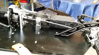

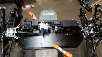

Made some progress since my last post. I went with everything FID makes for the driveline. Also replaced all three plastic diff gear carriers with dbxl-e all metal center diff gear carriers. Using the FID CD mount and brake assembly 20181223_142205.jpg

Thanks Man. It's getting there. I am going to use the TR air filter relocator with this reed engine. It tucks in there under the body nicely. The Crazy Stu ya need to cut the body to fit.
