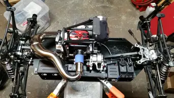

20190103_221319.jpg Well there it is. Got the TR relocator with a baja filter. Jetpro pipe.

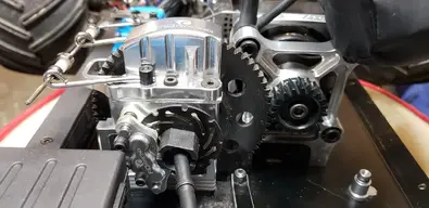

Using a TR clutch housing, Bartalone clutch bell carrier, Vertigo clutch bell and 20T pinion. Was a nightmare using these three manufacturers together. The Vertigo bell is a little longer and hits the TR housing on the inside. I had to notch the inside of the housing for clearance 20181231_124853.jpg

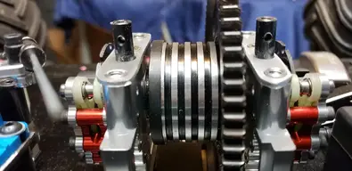

20181231_124731.jpg Right or wrong, it fits and functions.

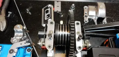

20190106_103834.jpg Ok as an update: I can't use the 20T pinion, it allows the center drive cup to hit the engine case once the mesh is set correctly. So I have a 21T pinion there now. But the pic is the 20T with the mesh fairly sloppy 20190106_103834.jpg
