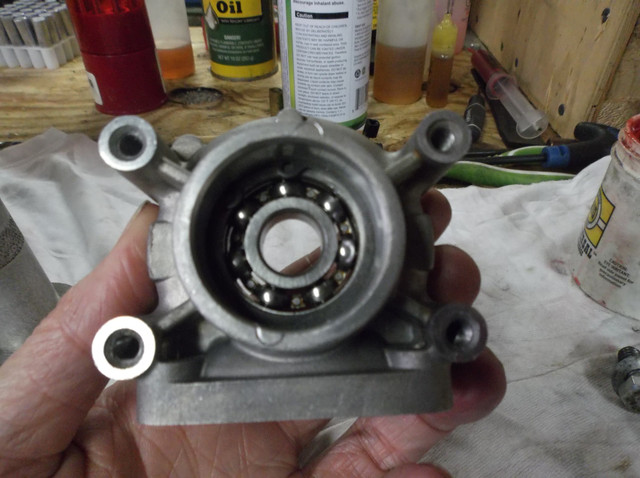

Issue #1) Upon a full engine disassembly I observed the flywheel inboard rubber seal was distorted. Looks like some type of bushing seal driver was used and too much force was applied and mashed one half of the seal. It was actually cocked in the bore slightly. This without a doubt could cause an air leak. You can see in the pic (sorry for slightly blurry) where half the seal is distorted. The seal is a "double lip" so chances are it would be ok but the seal probably would have worn out quickly from misalignment. Why risk all the headaches over a $3 seal ?? New crank seals on the way, and an installation tip I practice is to smear some synthetic grease inside the seal lips to help keep the seal lips from tearing upon installation , and the grease adds some sealing protection and lubrication of the rubber.

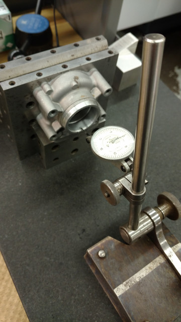

this build is making me loose what little hair I have left on my friggin' head ! My deformed clutch side crank seal dilemma now gets worse. What I was seeing upon a close inspection was the fact when I would assemble the crank and attempt to close the case halves together there would be an uneven gap, in other words the cases would not fit flat against each other. After depth mic checking all my crank axial end play I was supposed to have about .028" of gap. This is a pretty large clearance, the spec is supposed to be around .010" . Took the cases and crank to my work where I have all the precision instruments to be able to check flatness , runout and concentrically. I was able to figure out that the clutch side bearing (same side with the deformed crank seal) had the bearing slightly cocked in it's bore. So when everything was assembled a "pinch" was being forced upon the crank and not allowing any side to side play. Crank still rotated smooth. I used a press to remove the misaligned bearing and tried pressing it back in and no luck. The alignment was a little better, but still not right. Now i'm getting pissed off because I know that this engine was screwed up right from the factory and for sure I would have had a blown engine in short time. I had one last idea and this was to freeze the bearings, freeze the crank assembly then heat the cases to about 275F . I would then slip the bearing on the crank and quickly assembly everything by hand and let the crank establish the bearing alignment within the cases. To my absolute delight this worked like a charm ! With frozen bearings and the cases heated to 275F the bearings fell right into the bores and I assembled and bolted the cases together and let everything cool down. To verify I have the proper alignment I checked for the crank end play and with a gasket installed I have .012" of axial end play. Perfect, i'm done dicking around with this bottom end. Sorry for the long post, but now you can see how attention to details, spotting problems and checking tolerances pays off HUGE when dealing with garbage from China.
Pic of checking the bore alignment :

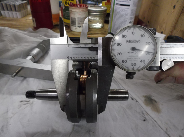

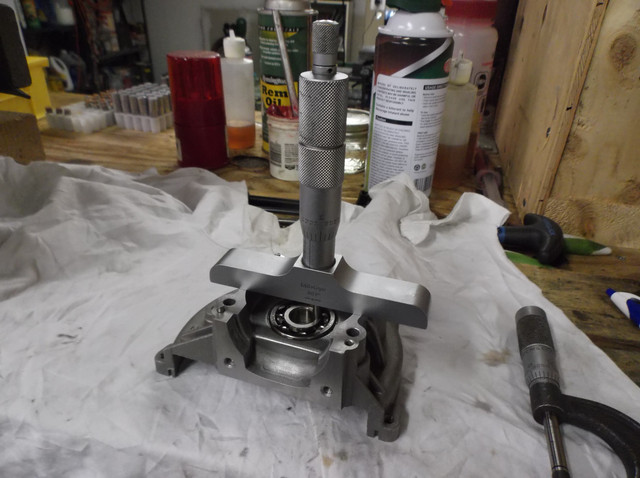

Here's a pic of depth checking the bearings to caculate the axial end play. Calculate both bearing depths on each case half, and add them together plus the thickness of your center gasket, then subtract the width of the crank journal surfaces and you have your axial end play dimension :

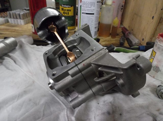

And FINALLY I have a true running bottom end. Crank spins very smooth, and I can feel the axial play by slight and SMOOTH movement of the crank side to side.
