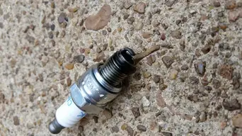

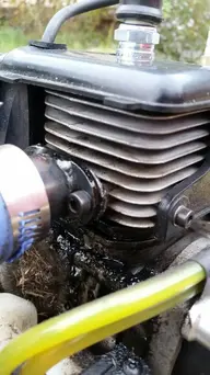

Ok, got new spark plug, put high and low speed needles in factory position then same thing, after 15 min of running it has so much gunk on the plug it will no longer run. Look at pics, it looks like my exhaust gasket is leaking, do you think this is my problem?d99af1e1b19317496ee572b04eb348f3.webp
Ok, thanks man. Will get one local real quick so I can work on it today and will order that good one put it on when it gets here. I'm lost when it comes to make it stop fowling the plugs so quick. Thought it was needel settings but guess not.

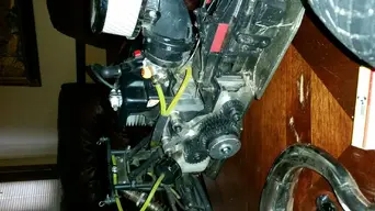

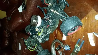

Do you think this air filter could be causing something? It's working like it should with no gaps or leaks, View attachment 7874
/monthly_2015_11/uploadfromtaptalk1446915001490.jpg.017f2970e8dba046f3bc2367c3e7d329.jpg
There should be a writing on the carb's bottom, if it's a Walbro it's definetely a retrofit.
