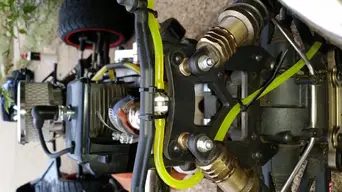

I got the air filter at a local Yamaha shop, thought it would look good and not sure what it goes to but it's for small engines. You think it could be causing problems? It's up high where there is less dirt and looks great with the body on in my opinion, you can see its big chrome thru the windshield. Thinking of taking it off and buying a filter made for it anyways but it's not priority right now.View attachment 7877

the 2 bolts set up provides not so great support for the carb and air filter. if nylon intake manafold gaskets - mostly the gaskit thats between the head-and manafoldiis prone to deforming and leaking. the added weight of the big air filter would add to this problem. - the gasket i just mentioned - i do not use it. i go to the ddm site and buy and install a graphite coated stainless steel gasket. - also, as these nylon gaskets deform, they can partally block the holes that are for the carbs pulse - pressure. just another thing to check out abd be aware of. the mess up above-- its the nylon gasket between the head and the intake manafold this is prone to deforming and leaking. d.b.
Good info, thank you. Next question is all that something I can disassemble? I have had the carb off but not the head. And thinking of some kind of support brace for that big air filter.
