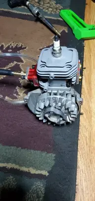

OK so i pulled the carb and pipe off.....blocked the exhaust port and the intake (only removed carb) will not pull a vacuum.... If I used a regulator how much pressure could i apply before crank seals leak?
If you put painters tape on the exhaust and intake port you'll see them swell and suck in on as you rotate the engine. Either bad base gasket, crank case casket or seals.
Proper thing to do is put like 5psi of pressure in and submerge the engine and watch for bubbles. Ive never heard applying a vacuum.

Almost ready

Vac and pressure test is std for checking for leaks in a 2 stroke. The case sees both, and the seals can leak vacuum and pressure, well the entire engine can leak under both conditions, but mostly the crank seals are a concern for vacuum. I don't reccomend going above 7psi, 5 should tell you just fine where you stand. I used to go 10psi, but had a trimmer engine push one of the seals out of its bore... long story on that but I've backed it off since then.
Headed to do it now stay tuned
Sorry guys got side tracked
the result is a crank seal on the clutch side... ive changed seals before by drilling a small hole in the seal the inserting a screw and pulling out with pliers.. anyone have an idea with cracking the case apart.
I have a sound shaped pic tool I'm thinking of trying to grab it in the center where it seals on the crank...very flexible there.. try pulling or prying there...I guess i'll find out tonight after work..
