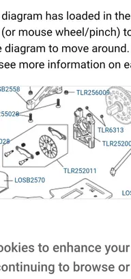

I have no idea, I don't have an actual 5t to see what the losi screws looked like. Do the losi brake screws, screw into the stock diff mount frames or did they pass through and get secured with nuts on the inside? The taylor 5t mount as mentioned does not have threaded holes and on the inside is some very small rectangle shaped recesses which appear to capture some nuts. I'd like someone to confirm the 5t brake screw setup. Some pics would be helpful.

So are you saying the losi screws did in fact freely run through the diff mount holes and are secured with nuts on the inside?
Perfect, that's what I needed to see Thanks a bunch! Those shouldered screws and nuts are what I need. Hopefully can find something at ACE hardware. lol.
