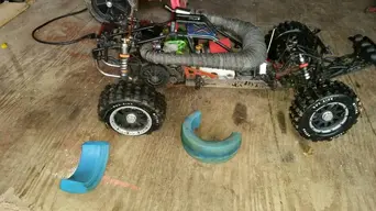

I found that when the intake is open I have about 2mm on the exhaust side open to the case.. Hell you can see light pass between the ports. Maybe if the skirt was longer on the piston it would have a chance but it looks like they went way overboard with the base of the exhaust port. I should have hit the pistons I have with the caliper to find one that will close the gap but Hey not one of my finer moment's lol.
Looks like I have more farting around to do tonight...keep ya posted!

Is this common to have such a gap between the bottom of the piston skirt and the bottom of the port on the exhaust. I have seen them close but never with this much space to stick a key into the case from the exhaust port.
If it's a mod motor who knows

I hear what your saying.. This head came off a 5b I picked up on the cheap
With this ported head stock and ran flawless for the last 5 months. This morning I put it back on the original case and has the same gap so that's not the reason why it won't fire up.. To be honest it should run better on the OBR billet case so now to swap back to the billet and put on a spare coil , kill switch and 990 to eliminate the possibility of those 3.. I thank you for your input you have given.

I got it fired up.. It was my coil! I will say that km ported head is a dog compared to a worn out OBR prostock lol. I don't run methonal or ethonal in my gas. I am going to pull the whole engine that came with this new addition to the fleet and drop in the losi full mod 7hp for a sand rail
There should never be a gap between the skirt and exhaust port floor. Its a defect. It will let spent fuel from your pipe into the fresh charge in the crankcase or let the fresh charge escape out through the pipe, or both.The motor is built for low end power and have very low timings,but some where along the line they goofed.
