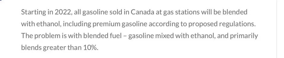

tbf yeah you're completely right with a decent oil (motorex race oil, same stuff ktm recommends for all their 2 stroke bikes) it shouldnt be a problem at all. its just a natural thing for me at this pointThe whole octane thing is about frivolous, untill your running high enough compression to need the anti knock features. In a stock ngune there's no real reason to run higher then mid grade, or highest pump gas at best. Ethonal gas in of its self is not any worse running then straight gas. Slightly less power, but we'll within the range if what the carbs can flow fuel wise. Poor storage and after run practices are more to blame then the ethonal its self.
