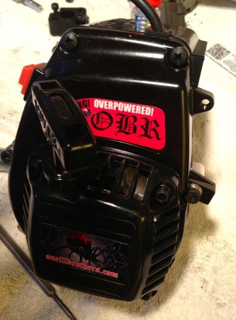

Just ran into this on OBR 30.5 with the billet case and mounting it in XB. did you change this in your set up?the OBR 30.5 billet will not go on XB without alteration to gas tank mount. the cover on the engine is fine, everything matches up. the case hits the bracket. is the old news? heres an image of the contact, spacers are in place with the chassis screw and the gear plate bolts are in and kinda snugged up but binding....more images will be over in hops ups and projects. i think this will help, did not see this in the discussion.

its ZENOAH, why it works fine, i could find no different except the case contact, which is BEHIND the cover, both cover pedestal are the same height and position. it was my initial thought but all fits fine
have to go back and add the kill, dah! so i'll get a side/side image.....
dude can't add images , but i removed it AND its a CY cover(stamped inside cover) that came on the ZEN from OBR.
guess thats why i did not have to change...still case hits mount

have to go back and add the kill, dah! so i'll get a side/side image.....dude can't add images , but i removed it AND its a CY cover(stamped inside cover) that came on the ZEN from OBR.
Like Rcgasser said, Zen pull start cover and Zen clutch housing needs to be swapped from a stock Redcat CY engine for perfect fit.

If you are using a zen you will need to change to a cy pull start housing.

hey guys i realize if its a zen motor the clutch housing and the cover have to be changed.
the billet case hits the gas tank mount and the zenoah motor from OBR COMES WITH THE CY COVER.
and the CY COVER that came on the ZENOAH from obr
heres the contact area with gas tank mount on the XB
motor mounted with mod
rcgasser said:
Cool mod I see that its your bottom screw that was in the way.
the billet case is SO thick behind the where the screws ends, the bracket got chopped , and in it went right to place. mill rips ! just finished breakn
