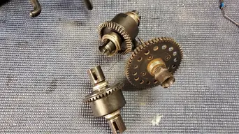

Thanks Sean??If your bashing I'd go something like 60k 500k 60k may be a bit lighter in the front diff.
Appreciate it E??in mine i run 60-500-100k fr-cen-rear but i need to redo front to 100k at sum point..?.but it drives sweet as is tbh?

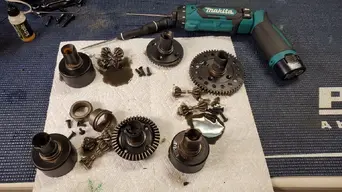

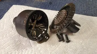

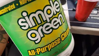

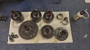

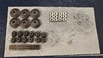

Thanks. Yeah, I let it sit in it for about an hour or so and agitate it with a screwdriver or something ever 15 minutes or so. Then I take it to the slop sink and wash each piece off with water and then spray wd40 right after then a light coat of silicone. With the Simple Green I don't fill bad about washing it down the drain??like ur method for gear cleaning ?
Believe me I thought about it? but since I bought this used and not sure what the previous owner used, so I wanted to clean it all out.cool?i normally stick a rag in around me finger ?scoop out whats left ?repeat then refill ?
not exactly the best method i know ?
