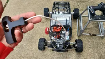

Big blocks are a bit of a pita. No choke or primer bulb. I would've used up most of my 60 second allowance if I showed that? I'll get it for ya in one of my full vids. I've showed it in my other vids thoAAAGGGHHHHH, I hate it when people don't show it being started.

Yeah once I thought about it I just put my hand over the filter then pushed it tight to the velocity stack and she started right up. Prior to that I had a slight pullstart mishap? The string cut on the cage that I snipped to allow the head to fit. I was pissed at myself.Come now lance, cant be that bad mate, just bag your filter and Doug's your uncle
#shorts baby ?????1st startup after transplant
What a bugger?Yeah once I thought about it I just put my hand over the filter then pushed it tight to the velocity stack and she started right up. Prior to that I had a slight pullstart mishap? The string cut on the cage that I snipped to allow the head to fit. I was pissed at myself.View attachment 68495View attachment 68496
Sean's favorite type??#shorts baby ?????
