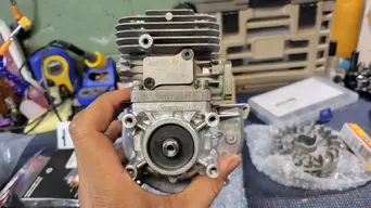

The rough patten on the intake atomizes the air fuel mixture better. I have heard the same thing on full size car carbs. Up until now haven't seen it on scale cars other than Arnold T. on FB.Great job, what are damos thoughts behind the intake design?
Supposedly. I hit up Damo to confirm. Gonna find out very soon. If it's a turd I'll let everyone know.Did they do any testing to prove it? Thats a 4 stroke principal that doesn't have fuel going through a crankcase to vaporize the fuel before going into the combustion chamber.
So you think smooth or rough would be no difference in power delivery? Then it's just the roostertail design if it can't hurt performance.No, there are many ideas of how to get more or airflow, make it rougher or smooth it out. There was an snake oil salesman years ago that was pushing dimples in intake tracts and combustion chambers. He claimed it helped with airflow, emissions and carbon build up. Little proof it ds anything, other then flow marginally more air in a naturally inducted system. About pointless on a forced induction system, anything with direct injection and mostly worthless with port injection. Seen lots of other crazy designs over the years as well. The tornado insert thing was pretty comical as well. Let's spin the air and make it more turbulent when the injectors atomize fuel better then any carb could hope to.
Really in two strokes were just worried about getting more air and the proper amount of fuel into the crankcase. The atomized fuel flashes to a vapor in the crankcase.
No I don't think it will hurt anything, I'm just doubting the effort is helping much. It's like the golf ball. The dimples help reduce drag through the air, and the air flows over the surface faster because if that. For whatever reason it doesn't work the same in engines. I'm assuming it's a similar principal he's applying here. Make a bunch of air dams/pockets where air gets hung up, but the air moving over the top has reduced drag because of the pockets of trapped air. So the incoming air should move faster. Idk how much it would increase the air speed over a traditional v-stack. Only way to quantify it is on a dyno, flow bench, or computer modeling.So you think smooth or rough would be no difference in power delivery? Then it's just the roossstertail design if it can't hurt performance.

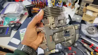

Yes supposedly. See post #18 for the explanation.The intake port is huge, it's nice porting
What the alloy plate betwwen the top end and the manifold designed for? Reducing the plastic manifold warp?
