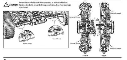

MCD racing thought it was a great idea to put a left handed thread there...if you buy a used MCD and don't check the manual and attempt to remove like a normal screw "anti-clock wise" they're cheap casting bolts will break at the thread in the arm.
both DBXL and MCD RR5 have reverse thread on the left suspension arms front & rear and when i bought used the MCD RR5 i assumed the previous owner replaced the left suspension arm bolts with silver ones because they were different and i didn't know they were reversed thread and when removing them they both broke at the thread i then later learn there reverse thread i was so pissed i thought they were normal thread but anyway i got a spare set of new arms included with the deal.
