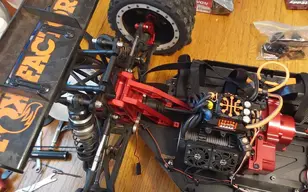

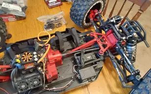

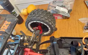

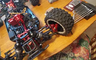

Got another batch of Vitavon goodies. Try to get installing them tomorrow. Front steering knuckle/carrier sloppy and bike one before so had the Vitavon ones but was waiting to see how everything else was going to work. I think I should have all the week points covered. Only thing left is center diff if it breaks....Put some pics on when done....

I am thinking about going with the Vitavon diff HOUSING in the rear only....first might do the front later but the rear takes this biggest hit.

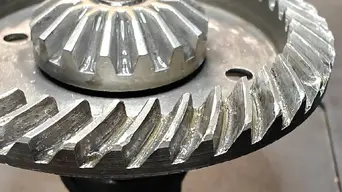

I open it up the rear this morning, I can see some wear on the teeth that was not there the first time I opened this diff. I am good as shimming so the diff gear and input were shimmed well. But what I am hearing not accounted for I assume is the plastic flex under power when bashing.
Those look good compared to mine .My side gears were trash and spider gears torn up.You noticed how spider gears supported only by plastic housing where the Vitavon use squares to support them.I had zero rear wheel power and the noises were crunchy and grinding. Seen lot of folks were killing pinion bearings but Vitavon uses larger one and stock size one.Same setup on steering/carriers. Any luck with ebay. Watch when ordering with shipping.....1st shipment was almost 50 bucks shipping, about five days. Second shipment was 17 bucks and took 10 days.I must have missed picking right shipment 1st time.Any questions I will do my best to help. Good luck!!!!!

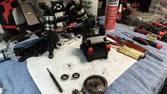

Vitavon diff it took me a long time to determine I needed to remove the other end in order to get the pin for the sun gear since there is not screw hole on the side of the diff like stock ...:lol
I did the black case
That's going to look super sweet when done. Took me a bit of time to figure out first diff but flew through second. Great quality from Vitavon. Thank you as always for sharing. IF you do front also the pin for drive shaft is tight ,some heat and small punch very handy. Referring to pinion/drives haft pin. I'm sure your aware set screw different in front and rear for the wheel to axle/extensions.
Thanks for that update. I did not get the front, but it is in the plans to do next. Vitavon stuff is so expensive this round. It was the rear diff housing, the round diff itself, and I for Vitavon crown/input gear since mine had some wear.
