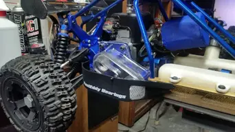

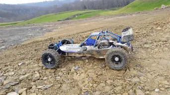

Finally got it on the ground guys!! What a blast! I am liking the taller tires for a little more ground clearance. Seems to steer better with the more narrow tires in the front than the rear. The aluminum differential housings allow the inner steering links to move further so I could actually steer lock to lock. The belt drive worked out well also. I actually found a US manufacturer of the exact same belt Stern uses. They also make a belt out of polyurethane and steel. So I am trying the polyurethane one. I actually ordered two. The rubber and fiberglass stern belt on my MT has some slack, may break I will put this one on in 20171222_172853.webp
Looks great !
I find the thinner tyres give better steering too.
Any idea what top speed you're getting with the taller tyres?
Believe me the rubber belt won't break.
I had a set screw come out and get lodged between the belt and the cover.
Got so hot it melted a hole in the cover and only left a slight mark on the belt.

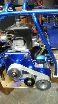

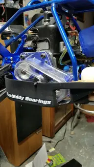

Thanks!! I love this rig. I have yet to put a gps on it to see what top speed is yet. Its so wet and snowy. Ya Man the belt broke on my MT after 9 months. Those big tires are a drivetrain killer. Plus I am very hard on it. Figured I'd give that polyurethane one a try and it's easier to buy from US stock not having to deal with ebay and Germany.20170625_234555.webp
Thanks!! I love this rig. I have yet to put a gps on it to see what top speed is yet. Its so wet and snowy. Ya Man the belt broke on my MT after 9 months. Those big tires are a drivetrain killer. Plus I am very hard on it. Figured I'd give that polyurethane one a try and it's easier to buy from US stock not having to deal with ebay and Germany.View attachment 13929
I never thought I'd see that after the punishment mine's had !
I have a couple of spares but if I ever need more I'll get you to send me a link to the steel ones.

Two other guys I know have also broken their belts on the MT. I think it is the big tires. You have had yours for a long time without issues
I think you're right.
