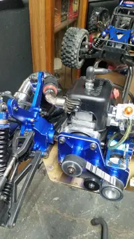

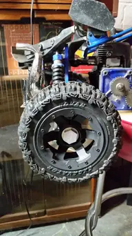

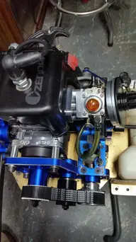

@Phill here are a few new upgrades. I broke a few teeth off my rear crown diff gear and decided to upgrade the housings and put a belt drive on it. I also got some Rovan truck tires a little taller hoping to get some top end

Looks good
I was looking at those tyres myself
How are they?
Thanks!! The DR has been down due to the crown gear. So i haven't tried the new wheels and tires yet. Should have it together for the weekend. I got them used. They are for the Rovan LT short course truck. We will see. Thinking I'm going to like the higher ground clearance.
I saw em on ebay
195 x80 rears and 195 x 75 fronts.
Be interesting to know how it steers.
Yes Sir. That's the ones I got. I will update once I get it back together.

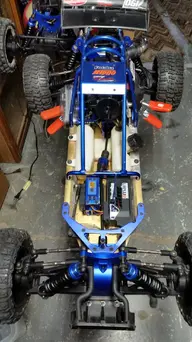

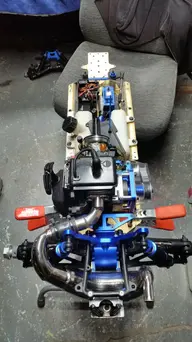

I am using the Hitec d845wp servo for steering. It is a big boy, so I used the aluminum redcat futaba mount. Had to drill and countersink two holes in the chassis for the mount. Now I am using a 2s 7.4v lipo, but it will run off 6v just not quite as strong. It's the best waterproof servo I could find for $100 US dollars. Tons of torque. I'm half tempted to run two of these in my MT

I am curious if these aluminum housings for the diffs will give more steering link clearance. They aren't as thick and bulky as the plastic. Hoping to finish it up tonight. I am also going to double up that top upper chassis brace in the front for a little more strength and use nuts and bolts rather than relying on those weak threads tapped in the chassis itself. Another question/ idea I have is. Will the 7075rc steering rack made for the XT work on the Dunerunner? I'm sure I could fab it to work, but not sure I want to drill any more holes in the chassis. I know it works on any X series
The aluminium diff housings would have to be the same or the dog bones would be too short?
Yes they are the same that way, but they are not as bulky. The plastic has to be thicker to handle the power. So I'm hoping I get a little more steering because of it
Let me know how it goes.
I might have to invest in some if it works out.

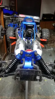

Well I get more movement out of the steering rack now with the aluminum diff housings. I can actually put the steering endpoints at 100 percent rather than 80 since the inner steering links no longer hit the plastic case. Almost done Man!!!
Sounds great.
Bumper looks good too!
