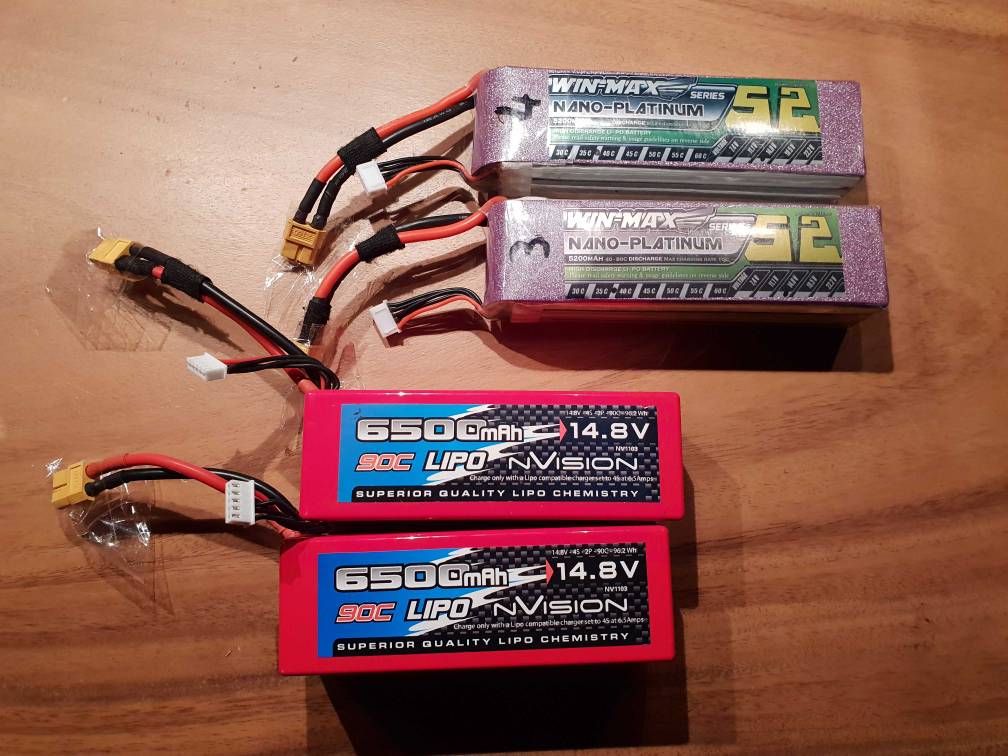

I did my first soldering last weekend. Most of batteries are XT60. Is XT60 ook to wire to all my stuff? Finny to see how much money you can still spend on small stuff like that just to get your car going
XT-60 has 3.5mm bullets which are as the name indicates up to 60 amps. Short bursts often exceed this with no issues.
I think this size is good for smaller RCs up to 3s, but not for what you are doing.

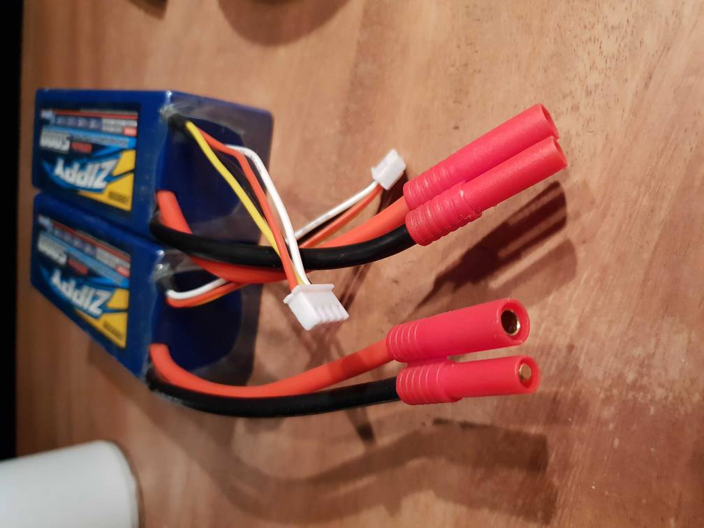

At a minimum I would run XT90 (pay a little extra and get the anti-spark model)
But if you can afford it the castle 6.5mm are nice or the EC series. (I have EC8 connectors which are 400 amp rated)
