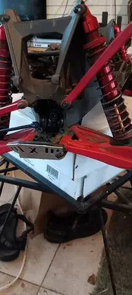

Had a little squeaky sound driving my x maxx, drive cup worn a little mad the cup screw break in the axle gear...off to the lhs, I wonder if I can make it out of the store with just these parts???
Starting to have a problem 😕
