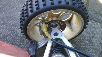

there is another way to get better stoping power from fg cable brakes
if you get 2 of the larger disc's used with hydro set ups and space the caliper out a little bit with some home made spacers @2-3mm if i remember right this gives you much better stoping power and as long as the cables are ok and not kinked or bent then you will be happy
