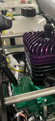

If u r running taylor 50 u only use one line and put a breather on the other side.My posts probably show a picture just like the one from Rc madman.
Here is a picture, albeit poor, showing the breather at the tank and the solo yellow hose to the carburetor.
Awesome. Yeah thats where I went wrong, I just blocked it off completely
