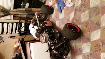

Yes I got the message and it worked. The transmission was in 2nd gear the whole time. As soon as I got it running and opened the throttle (it was a lot stronger on take off) I stripped or loosened a drive shaft nuckel (not sure what it's really called but where the set screw is on the drive shaft coupling) and have not had time to find it yet, i have 4 kids and been doing family activities all weekend. I'm thinking it's somewhere right after the brakes and before it splits from front to rear drive shaft. The transmission would just spin, then grab, spin then grab after that first really hard launch. I was on concrete with tarmac busters so it was grabbing good. I do remember when installing the transmission there was something I did not like with a set screw in that area. View attachment 7887uploadfromtaptalk1447639041352.webp
