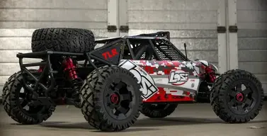

I'd like to make it look like this one:
What tires are those? What about that small black "TLR" section. Where can I get one of those? What about the plastic fake "mesh" around the cockpit?
Finally, what do I need to know once I get it as far as things to check. It's obviously been broken in already.
I know because I was interested in exactly the same look myself.
Looking at the pic I would say its on rears and fronts, whereas i went with fronts all round for mine, nice setup but quite a lower profile compared to the stock DBXL tyres, can look a little daft when you first put them on the car.

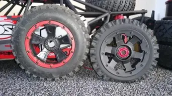

What about overall height of the Hostiles compared to stock?
You'll definitely notice a difference in top speed with the shorter tires. A big difference actually. I ran Baja 5b tires all around on desperados for a few laps at the track. It's like running a 19t pinion compared to the 21 tooth. Looked bad ass but would be good on grass or a muddy type surface.
3/4" is a big difference in height of the tires. It really changes the overall look of the DBXL. That photo provided by Tisane clearly shows that.
Found this photo: That's a big difference. I think I'll stick to the stock tires/wheels.
