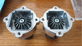

So it turns out the IRC diff housing is the issue. With all the internals installed the 2 halves don't meet up at the seal. Something wasn't milled correctly on the inside of the set I purchased. That was a waste of money.I would have taken a pic but my hands were covered in silicone oil. I built up the HPI diff and everything went together no problem. Well sort of . The F'ning Gear that mounts to the diff is a freaking rovan part It doesn't fit over the larger side of the 2 halves where the bosses are. I need to sand them down about .005" . I'll do that tomorrow.

Sorry to hear you having a problem ? i did a dry fit to make sure it was going together before i added the oil? and what i found was the cap screws hold in the pins where not done in properly Screenshot_20200614-123942.webp
And they where catching on the spider gear pins.....?‍♂️

Also putting the brass squares all up the same way seemed to help ?

What do you mean by the "Cap screws not done in properly"? I noticed one of my cap screws sat proud of the big spider gear . No mater what I did it stuck up higher than the gear. It's the same way in the HPI housing too but at least the HPI housing goes together all the way. The other thing I notice is your brass plates have the rounded edges going up and down . I can't even get my brass plates to go in like that .
