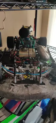

Thanks for the input. I probably wasn't clear on my original post (and since then, the car showed up!)
If you look in front of the gas tank, there is a blue line going across from the front master to the rear master. I was more referring to that setup.
Thanks again!

Other then not being able to set right to left bias I don't see a major issue with how it's set up

Wait a min, been studying that pic. Somethings a bit off. Can we get a shot looking down on the whole model? I see that line your referring to now, and it don't look right. I was looking at the tubes going out to the front wheels.
Just a guess but I think that tube crossing from one master to the other is used as some sort of make shift reservoir.
@Striikar you see what I'm talking about? Hard to see in that pic

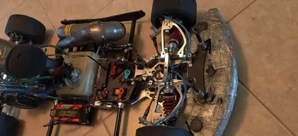

Yep, just didn't have time to further investigate. Thought something weird,it's why I said "interesting".
I need a better pictures.
Mkiiina are those rear brakes "cross- hydro"?.
Where's the front brake to pump line?.
Is that a tee - line to pump & rear brake. Somethings funky...
Do the brakes work correctly?.

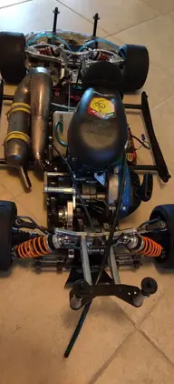

More pics! Yes the brakes work well actually. The fronts are driven off the cylinder on the battery side, the rears are driven off the cylinder on the exhaust side. The line in the top (what I'm calling a cross over) is just tying the 2 bleed nipples together it appears.
