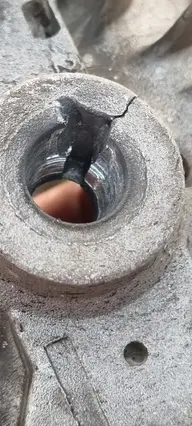

So, pulled it apart, coil tight, flywheel tight, couldn't see anything, so ripped into the engine wondering if the clutch was loose etc. Pulled flywheel off and the key fell out, but in a funny way. This is what I've found, I don't know how I manage to feck things up like this. Anyways got 3 or 4 spare flywheels but they are stock, so gonna spend half hour on the lathe tomorrow and mod them for the easy start.
Wouldn't mind but I had a spare machined flywheel, fitted it to the Baja just yesterday FFS.

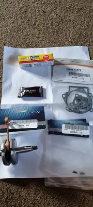

Anyways some pics of the damage, crank looks fine BTW.

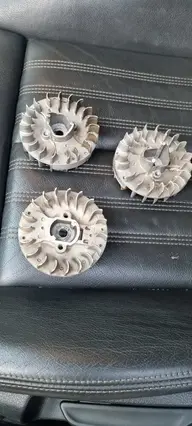

Last image is 1 machined and 2 spares that need machining.
