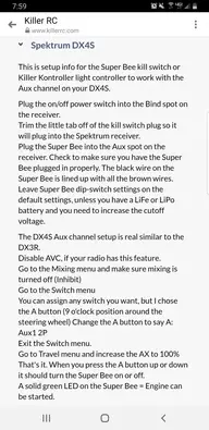

I have a Spektrum DX4S with non-AVC RX. I can not for the life of me get the stupid damn thing to die when I kill the transmitter; the green light is still on and my buzzer isn't buzzing. :mad:

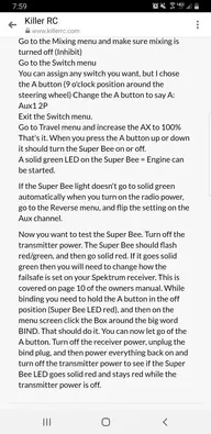

I have set the failsafe to full brakes and turn left. I tried through the instructions from Killer RC to have the kill switch in the off position, then hold the switch in the off position and applying brakes while binding.

I have that print-out. I did that nine different times and got the same damn green light on the K.S. when I turned it off.

Assign aux to channel make sure end point is set to 100 check if you can turn KB on and off with switch... proceed to rebind with the KB in the OFF position

Okay, after another two days of fukin around with this stupid thing 🤬, I tested it with my futaba 4PV and all that took was putting the kill switch in the aux channel and turning it on/off and when I turned the TX off, the kill switch TURNED OFF!!!!!!!!!!!!!!!!!!
With the economy in the dumps because of this virus, and no one has it, I bought a FUTABA 4PM 4 channel radio off Amazon because I had a $100 gift card from my credit union that hasn't been used :happy:.
