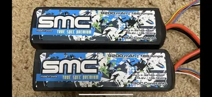

Yep, thanks for that. I’ll look into the 1” extenders. Bigger batteries for the project are in.

Think I saw my shipment coming in.
Side note.. Grabbed an Xmaxx last night for $460 included a charger, tons of extra parts: new wheels, all a arms, etc etc... TQI bt adapter, 2 sets of awesome batteries (this is how I got the SMC’s and the main reason I have another XMaxx now)
Yep, bought it just for the batteries.
