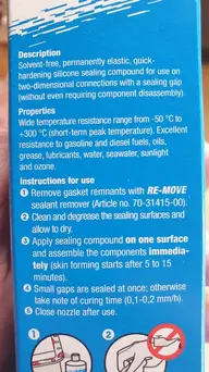

what ill do before i install the gasket is apply a bit of 2stroke oil on the gasket (little smear of oil)
What is this stuff ? Cant i just oil them?Hylomar
Don't forget that google existsWhat is this stuff ? Cant i just oil them?
Tube is close enough.looks like there is only a tube available here
id have to wait for the new year and get it there
getting sticky/dirty is all part of the funTube is close enough.
You'll just get sticky fingers
Good tip Sean ? although i was just gonna go for a very light smeer?Looks like good stuff. I'd only use a wee bit on it so it doesn't squid inside the manifold.
