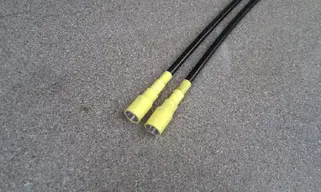

pulled off the brake cables and found both to be very sticky...so decided to chop up a mountain bike cable and make it fit instead of spending £20+ on new cables..5 mins on the lathe and they now fit the calipers correctly..
got to make a new block for the other end of the cables to pull against.

heat shrunk the new cable brakes for that little bit more support and they fit nicely...still got to make the brake block for the other end..
happy with the front shock tower..looks alot better than the original plastic front towers..cheap bling ...:lol::lol: and the brake cables are now alot more protected hiding behind the bumper and under the tower...
