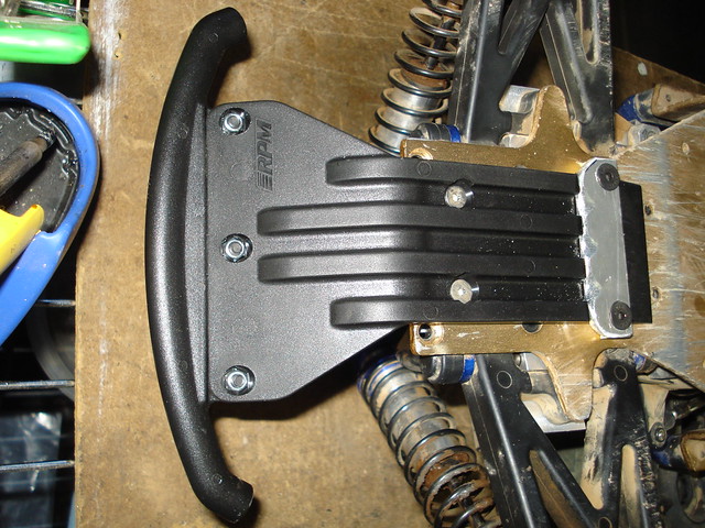

Thanks, I wasn't sure that was coming across in the picture. The bumper is also notched so the bridge recessing into it. The bridge sits flush w/ the rest of the bumper.

I took the DR to the track today and got through two sets of batteries, i.e. 50mins of runtime, with no broken parts. The rpm bumper is worth every penny! I cartwheeled the DR several times and in that past something would have broken; the bumper took all the impact w/ ease. Aside from the bumper, I also made the suspension arm tabs/braces for the rear arms as well. I'm starting to feel like I'm getting ahead of the weak points and can start to count on the reliability of the DR. I also changed to a 2s lipo for the steering: http://www.hobbyking.com/hobbyking/store/uh_viewItem.asp?idProduct=20422 It may look a bit on the small side but it gives about 40mins of usage. It's a good battery and you can charge it in under 10mins. Also, I"m still running the turnigy servo. It's been a good value. My Savox was returned and I've not received any info one when I'll it back. I'm probably done w/ Savox.

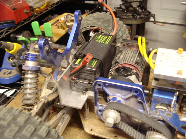

Making the mods to support 14s, 10A i.e. 11k watts :) This didn't require the mill but I did have to get out the sewing machine!

The next major mod is going to be the 14s fitment. The ESC and batteries are going to have to be situated differently. The goal is to keep the wires as short as possible and fit the batteries.

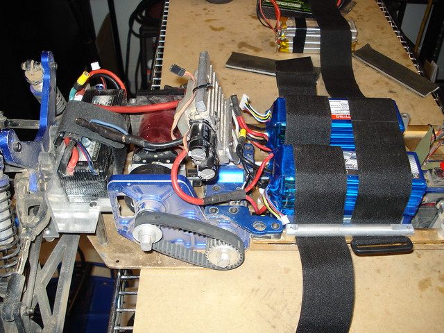

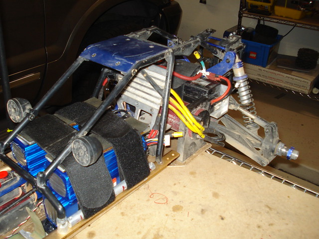

I managed to just about complete the 14s conversion. I was a soldering fool, I tell ya. You can see from the pictures I had to rotate the esc up to get more room for the batteries. This increases the airflow to the esc and motor. There are additional batteries in the back which will help w/ the balance of the buggy too. This is the set up w/ 14s 10A, there are 28 5000mah cells in there. I need to weigh it but I don't think I actually gained that much more weight. I also switched to velcro straps b/c I needed to accommodate varying sizes between 8A and 10A packs. The straps will also quicken battery removal which now requires me to take off the roll cage. I need to come up w/ a quick disconnect for the cage. The other item is the brake linkage needs to be relocated by 180 degrees and run between the packs. Any and all ideas are welcomed.
I agree but they don't make 10A 6S packs or at least ones I can afford. Also This might be one of just a few e-1/5 that are getting 30+ mins or runtime on a single charge.
Maybe a long term project would be to relocate the servo tower and get all the packs to lay flat in the chassis. It sure would look better.
