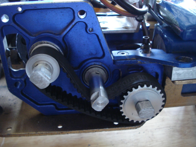

I have my belt drive just about exactly as I want it. The pulleys are mounted well and everything spins freely. The only MAJOR issue I'm having is the belts heating up. They get hot after just a few minutes and even melt a little bit onto the pulleys. I don't know enough about belts to know why this is happening so if you do please chime in. But this has to be the reason for my belt failures.

My first thought from your pic is too much tension on the belt....the RCpitstop belt definitely has some play in it.
Sent from my Shoe-Phone using Tapa-Toe 2
What is the belt material? The Kevlar belts can't be back bent. That is the reason the belts that come with the kits we sell are fiber reinforced. The rubber material comes into play also.
The belts are from: http://www.econobelt.com/Q460/RFQ/default.asp?Page=tbelt/10.htm
It says: Nylon covered, fiber reinforced, neoprene.
The tension is good, it's not too tight, it has a nice amount a play. Not enough to inhibit rotation but not loose enough to slip.
What I think is happening is when the car coast the belt actually rubs against itself under the idler pulley. There is just enough slack that when off-throttle I can see it bunch up. I'm going to try and fab up some delrin to put in the middle that'll act as a guide to keep the belt from rubbing against itself and instead will rub against the delrin.
I have to try something b/c time is running out. If you have any other ideas I'm all ears.
