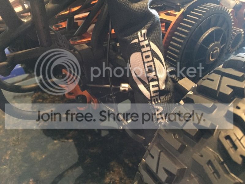

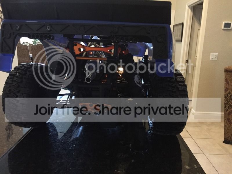

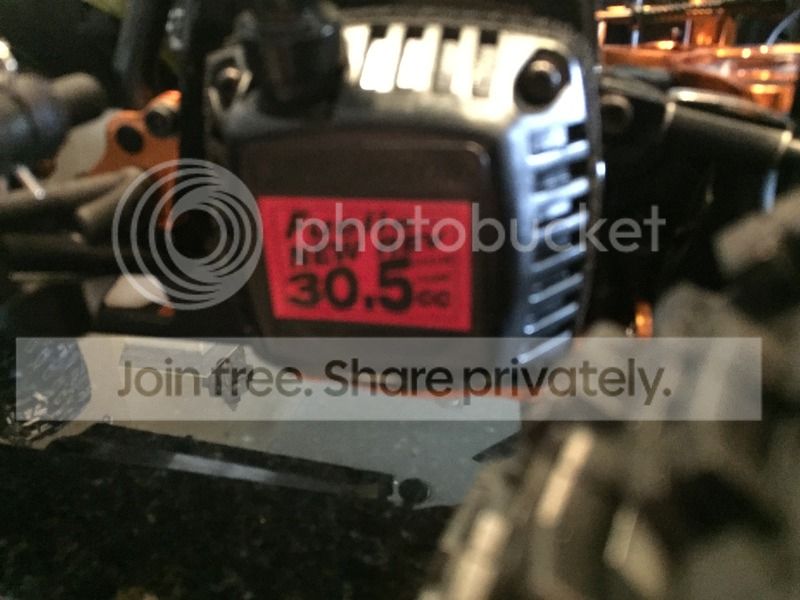

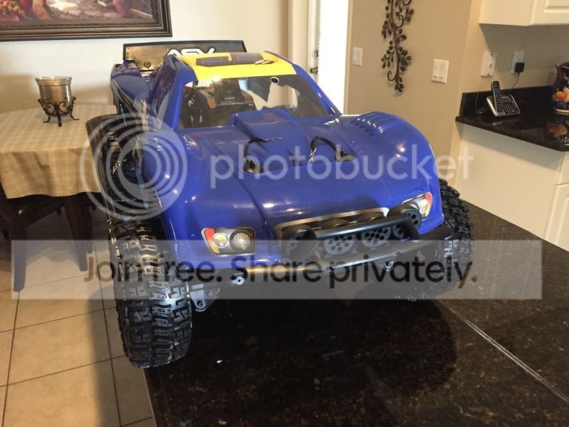

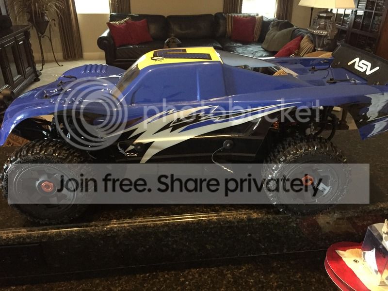

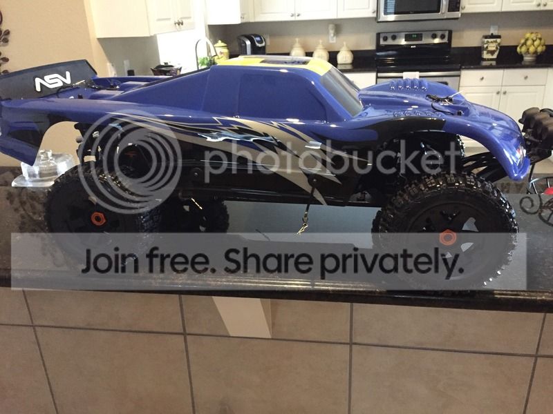

As requested, here are a few shots of my new KM Baja 5T. Blue factory painted body (side graphics painted into the main color, not stickers). Shockwears installed. HPI HD aluminum clutch carrier installed. Killer RC limiting cables on as well. Came with a 30.5 cc Fuelie motor. I ditched the KM radio for my Futaba. Waiting on Fast Eddy steering shim kit, Turtle front plate Turtle rear shock brace. Proline Trencher tires and Desperado wheels (not the KM knockoffs).
I am a little disappointed in the body. Seems pretty thin for a 1/5 scale. I've been looking at clear bodies and the HPI is $169. Wow, guess I will wait til this blue one is toast. :wideyed:
Yeah for the price of HPI body I would go with woodster lidz. $100 plus shipping. Stronger than HPI for less money. A buddy of mine has the stock Rovan body and the back end folded and cracked.

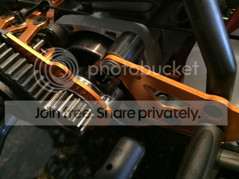

Another thing I noticed with the rear hinge pin brace is the metal is not hat strong and bends east. In the process of shimming the front and rear suspension to get rid of some of the slop, I removed the rear brace and it was bent. I straightened it out OK but man was it easy to bend. I have a friend that works with carbon fiber aircraft parts that can duplicate the brace for me. I may have to take him up on the offer.
Thats strange, on mine, and you all well know, the baja takes a beating, and those plates you are talking about are as good as new on mine. I have landed mine where I hear the slap sound of the bottom of the car against the grass surface, it breaks steering linkage, arm bolts, but the plates are fine, no bending. There is some play, but its normal to me, the same is for the X2. To minimize I placed some washers, and used automobile vacuum line, which has about the same inner diameter as the pins, as spacers, and is super strong polyurethane plastic/rubber material.
The rear plate was bent badly so in fixing it I noticed the aluminum was very easy to bend. Not good quality. I am ordering the HPI plates. I'm thinking batch this plate came from is a bad one and someone screwed up the metalergy.
