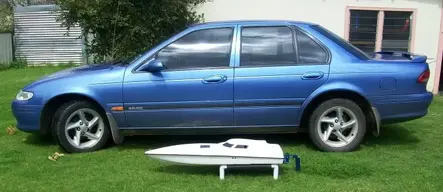

any way here are some pictures of the patched up hull, the installed pico and the new gear installed on the back of the boat, it turned out ok for a back yard benckie bodgy job, ive had fun and learnt alot, and would not be affaid to build a boat now.
