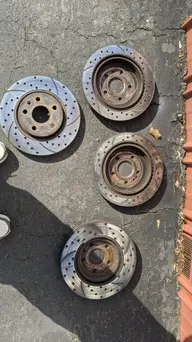

So I finally got to do a brake job on my Camaro today . Finally some warmish nice weather. So a few years ago I had put drilled and slotted rotors on the car with new brake pads.. Interestingly it turns out that the brake pads I installed are actually harder that the rotors that I put on . Go figure. So I got to do it all over again to say the least. The old brake pads actually wore the rotors down so that the slots on the back sides were almost gone. I've never seen this happen before.

New BEAR Brake rotors and new pads.IMG_20200425_163147.webpIMG_20200425_163157.webpIMG_20200425_163204.webp

Wow, never heard of that, at least not with both the pads and rotor being replaced at the same time..... wouldnt buy them rotors again
Yup totally agree with you. The rotor on the left is what the back side of all the rotors should look like.
