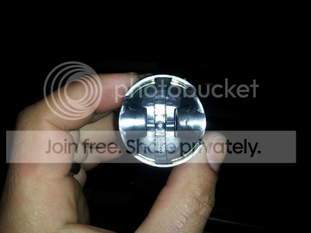

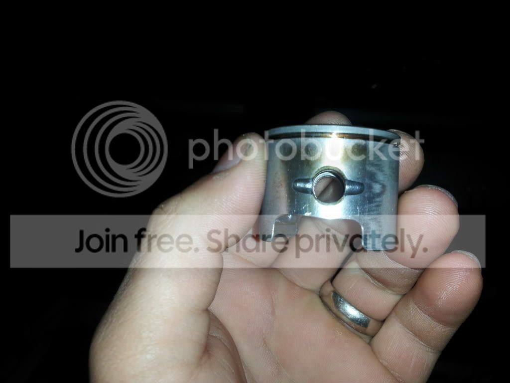

Hey Larry I was noticing that my piston is a little bit of a different design then yours. The skirts are off center.
How would I lighten / port this piston.
I also notice that the exhaust/ intake port line up with the piston. So if I open up the ports on the head I should do the same on the piston.
