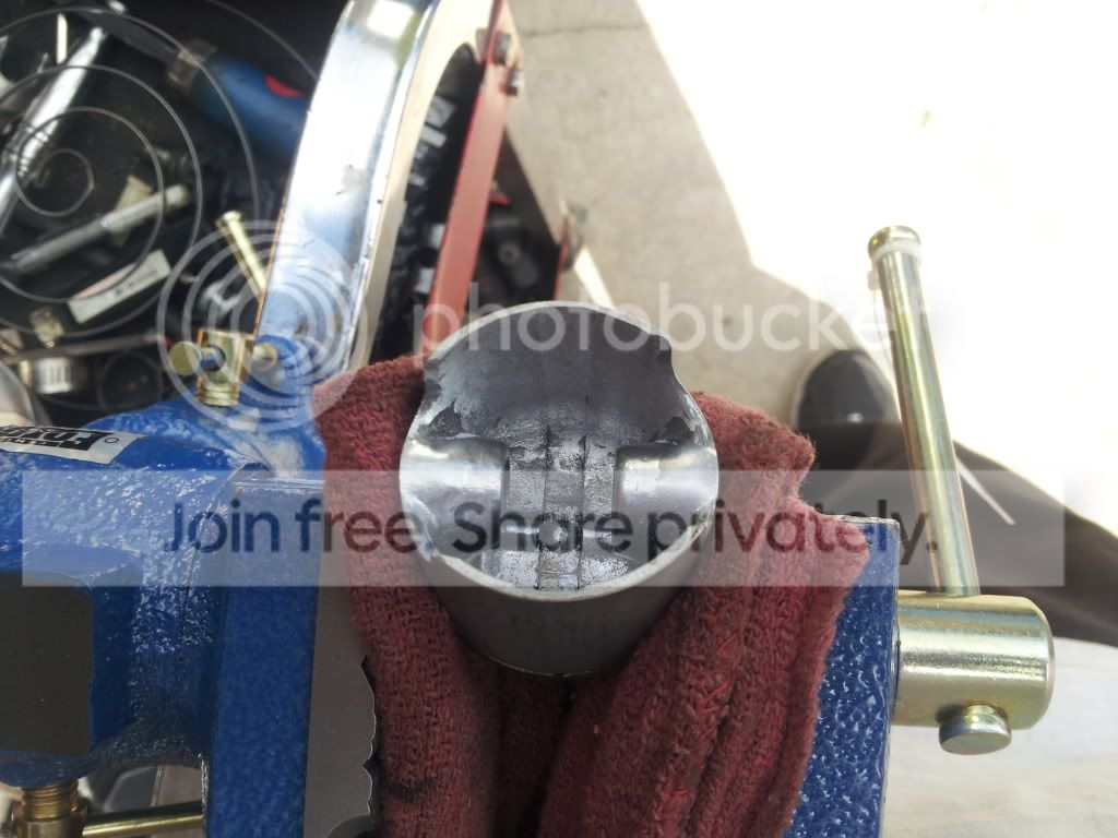

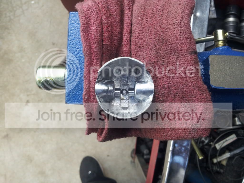

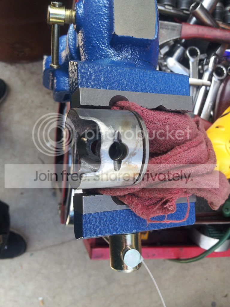

OK got it. Now for the piston I see in your pics you knive edge the openings by the piston pin and take some material from the inside. Is that just to lighten it up or is there other reasons?
Yes when u look at your piston you can see a edge that the factory made to put the piston in a lathe,this is what you remove and down were if the piston had 2 rings you can buff some of this off.But don't do it were the pin is,if you hit the pin you might make it loose and fall out when the engine is running.
Now if you didn't take much off the bottom of the intake port were the port hole is you can remove 1mm off the piston skirt no more at this time.and when you look at my piston you can see i angled the wall by the pin holes.
OOO and when you put the C clip in the piston put the opening at 12 not 3 or 9 were the notch is.If you do you are going to loose the C clip out of the piston and kill the head.I and a good friend has done this by putting the C clip at 3 or 9 and lost all of it.
Now with this mod i run 250ml of oil per GAL of reg fuel.and don't forget to sand the edges of the nice ported head.
It's all good if you got any more Q just ask.

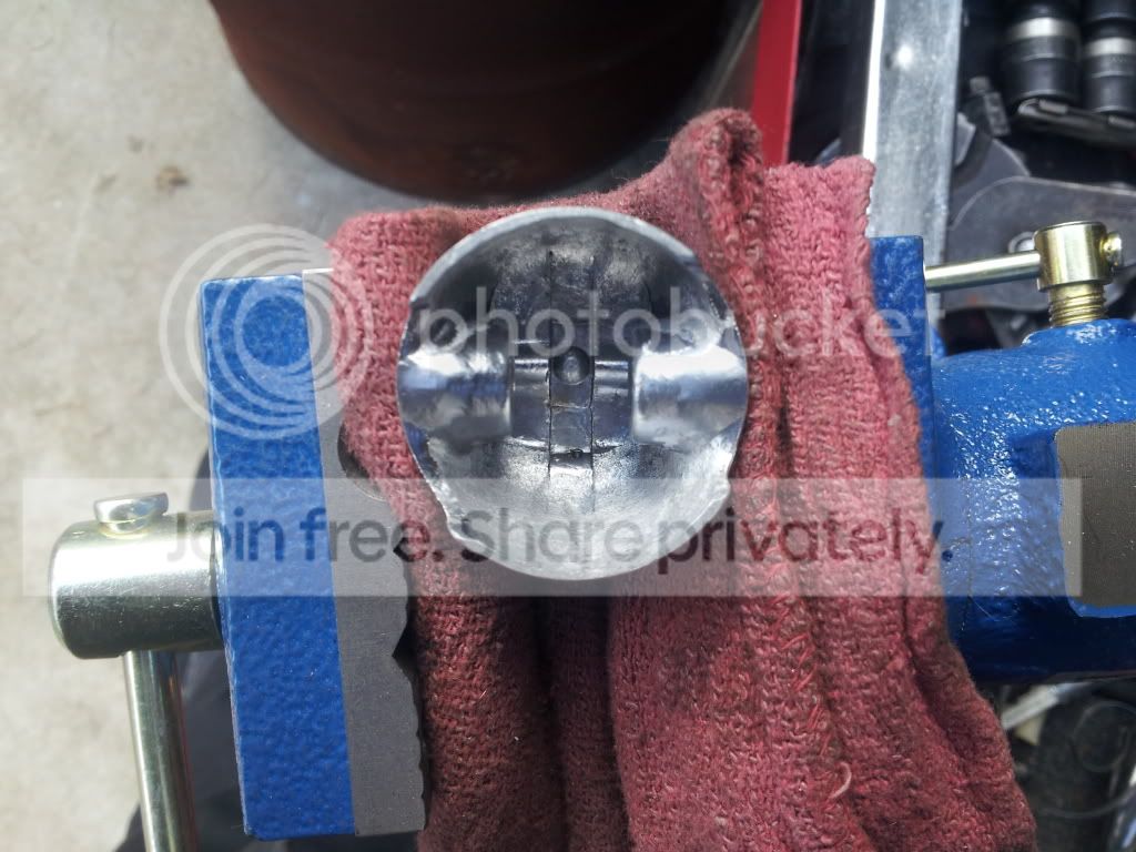

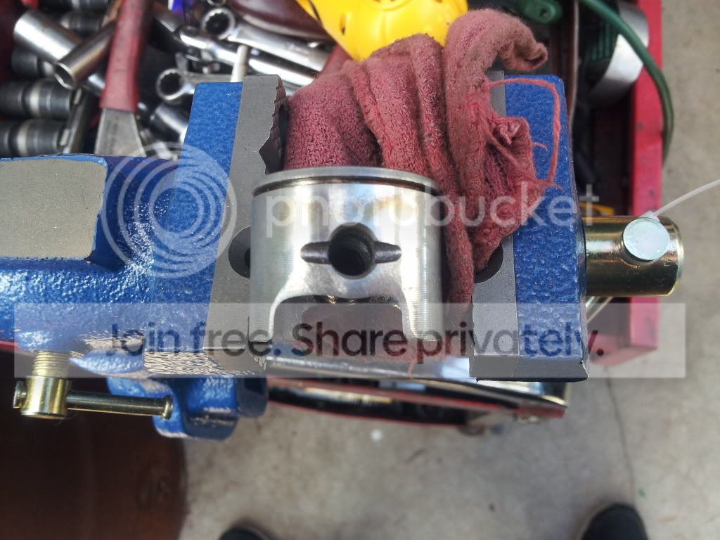

OK here it is. I hope I didn't mess it up to bad. Being at home and taking more time on it helps. I should have waited to do the head today. It most likely would of came out better.
I was going to temp to take out the little ball and humps in the bottom of the piston but not having the right bit makes it hard. So tell next time I have it apart and the right bit I will do it.
Good job now all you need to do is sand the sharp edges on the piston skirt.And if you don't have a 8000rpm spring get one you going to need it.
You just made a screamer and is going to hit the high RPMS with a good pipe.
There is no need to take the little ball and humps out of the piston.
