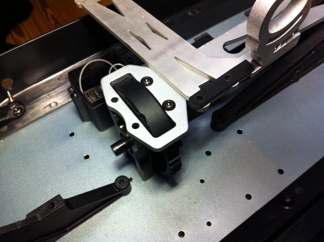

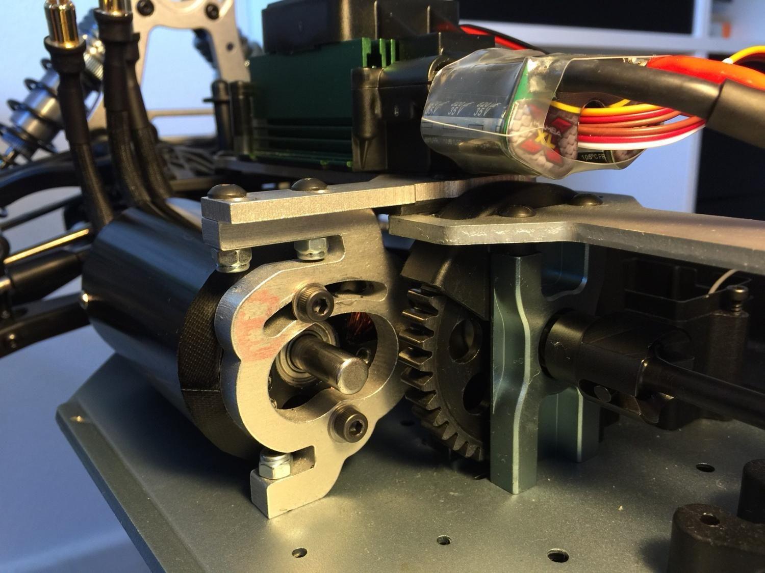

Motor mount:

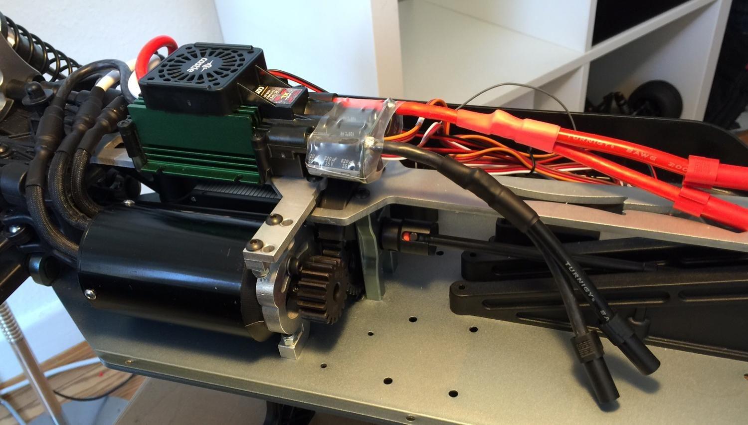

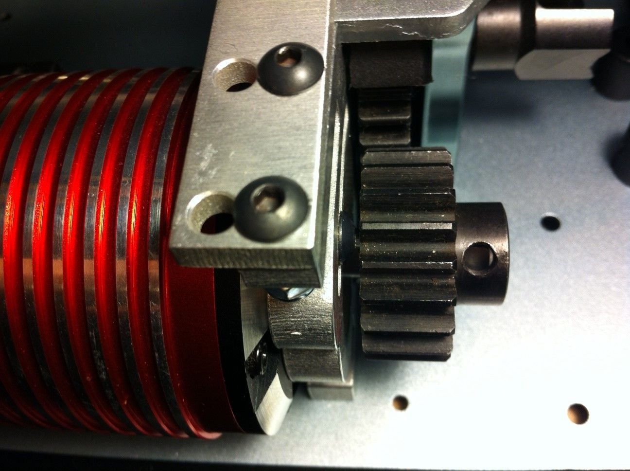

I opted for the Kershaw mount, because of availability and price. It takes a little bit of fiddling to use it with gear cover and have both the top plates nice and level, but that's part of the fun. The 2 mounting positions to allow for motors longer than 106 mm looks nice on paper, but in practice, with the mount in rear (2028, 58110 size) position, the mounting screws basically limit pinion sizes to max 13T, unless running the gears with a bit of off-set... Means the need for big and heavy tires to gear up with mount in 2028/58110 position, or using >8S, but those ESCs are still way to scarce unfortunately.

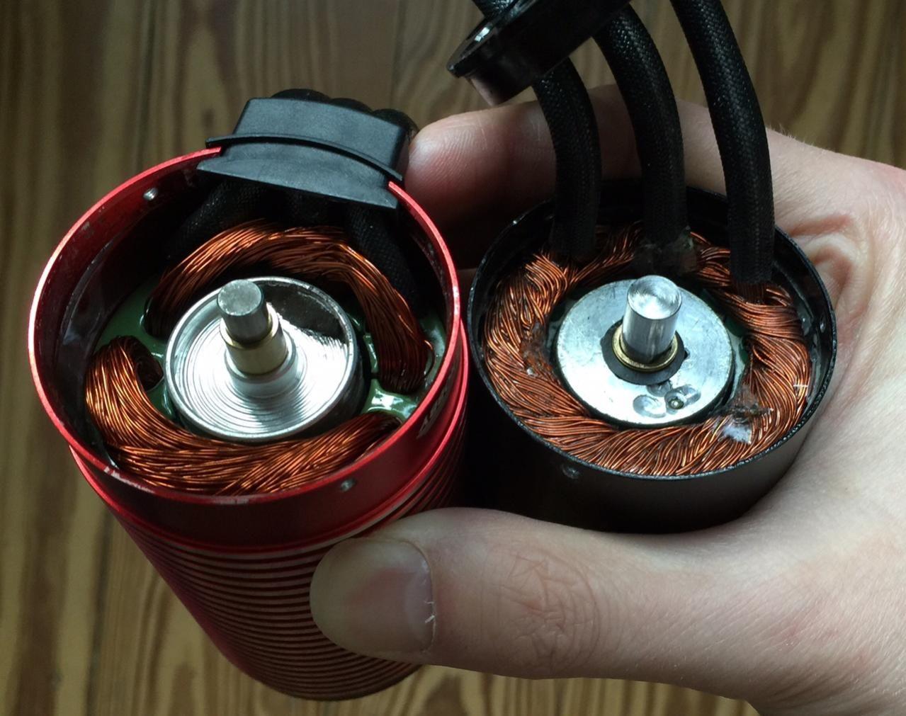

Did quick little kv test. No-load current of the TP5670 is quite high, over 2 times as high as the Leopard. >10A at 22V is >220W doing nothing but generating heat. That's about 3 proper soldering irons :o . During the no-load kv test, the 960 g TP5670 accelerated noticeably more violently than the 1100 g LBP5898, suggesting higher Torque.
Anyway, looking forward to some more testing to see how things will be under load. Seems the Leo is actually going to be more efficient at lower loads; question becomes at what loads they cross-over. From what I've seen, I'm expecting the TP to hold RPM better than the Leo, which at some point will drive the Leo to lower efficiency... at least that's how I think it works...

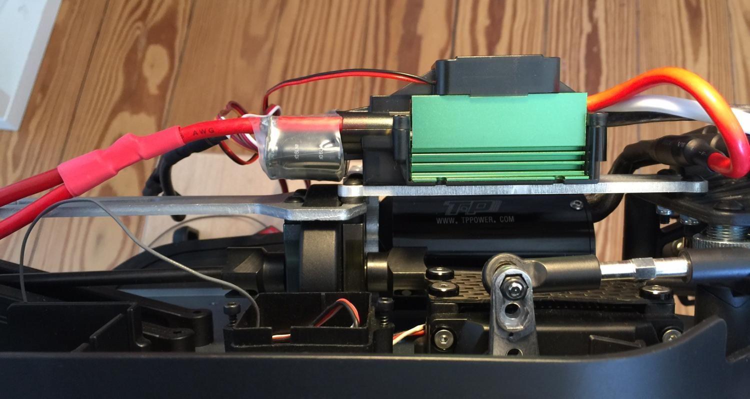

Will try the updated Mamba XL (X). Thought about getting that new Toro Beast ESC, but reading how SkyRC seems to have screwed up the accompanying software and datalogging, made me choose for XLX, although I have seen the XL2 getting a bit hot in Othello's Carson Dirt Attack - which is same car with different badge. Castle's datalogging keeps being one of the big selling points for me though.
Didn't open it up to check the inside caps, but the new XLX front caps are 2x1500uF instead of the 2x680uF of the XL2. The integrated cappack is 4x820uF. So, assuming internal caps are still 2x560uF like with XL2, total capacitance is 7400uF, compared to 2480uF of the standard XL2... that should produce some manly sparks!

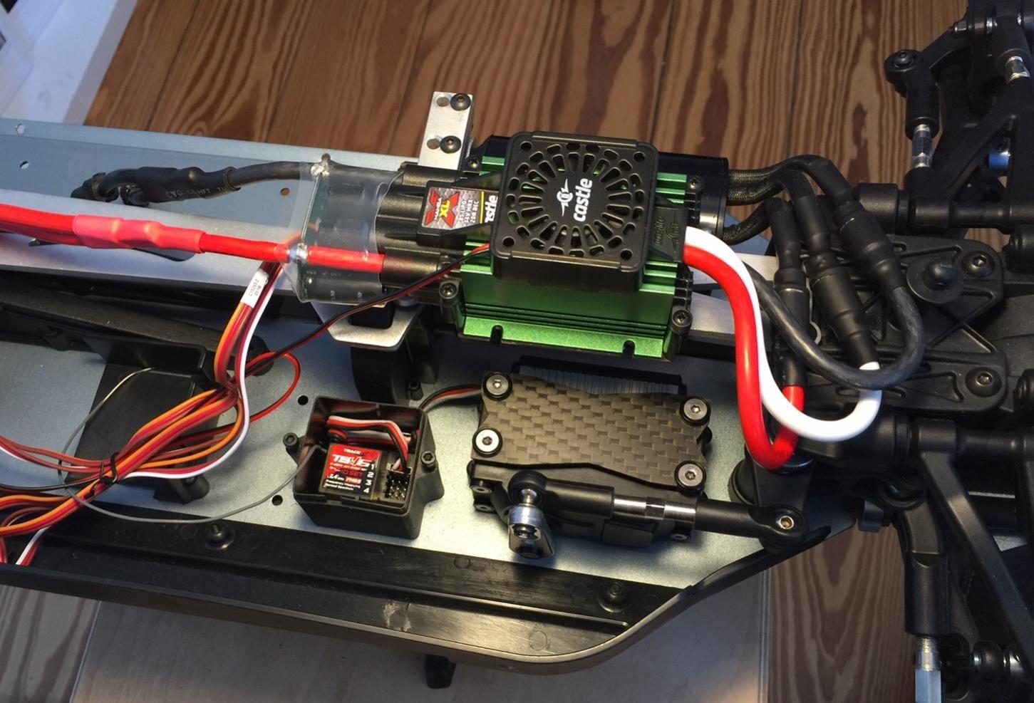

Although the added cappack seems like a bit of an afterthought, I think it looks pretty decent (at least better than when I'd have to add a bunch of caps myself) and the added length doesn't matter for this car; in fact, the form factor of the XLX works pretty well here, and I can (just, but) still fit the buggy body with the ESC mounted on the front top-plate.

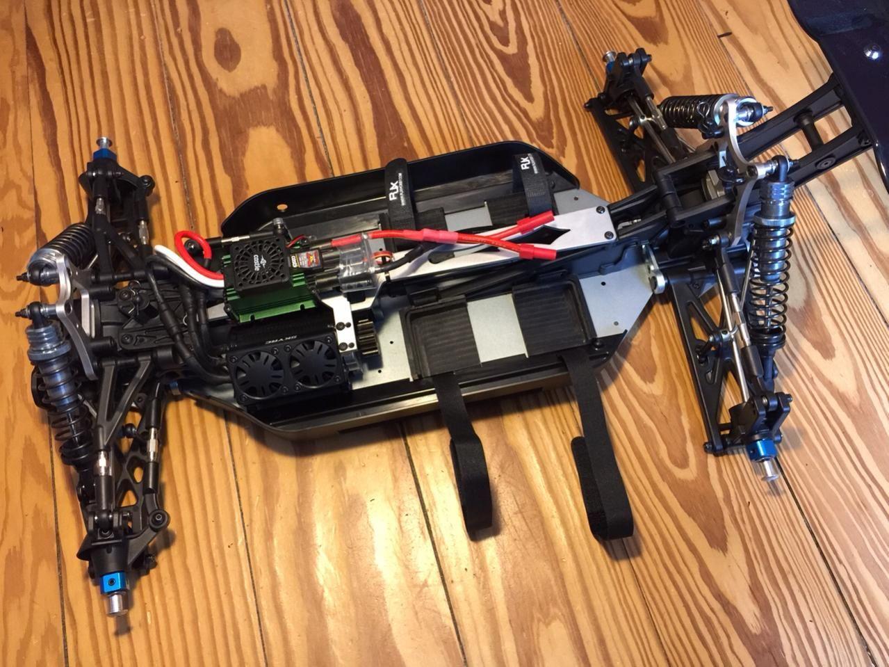

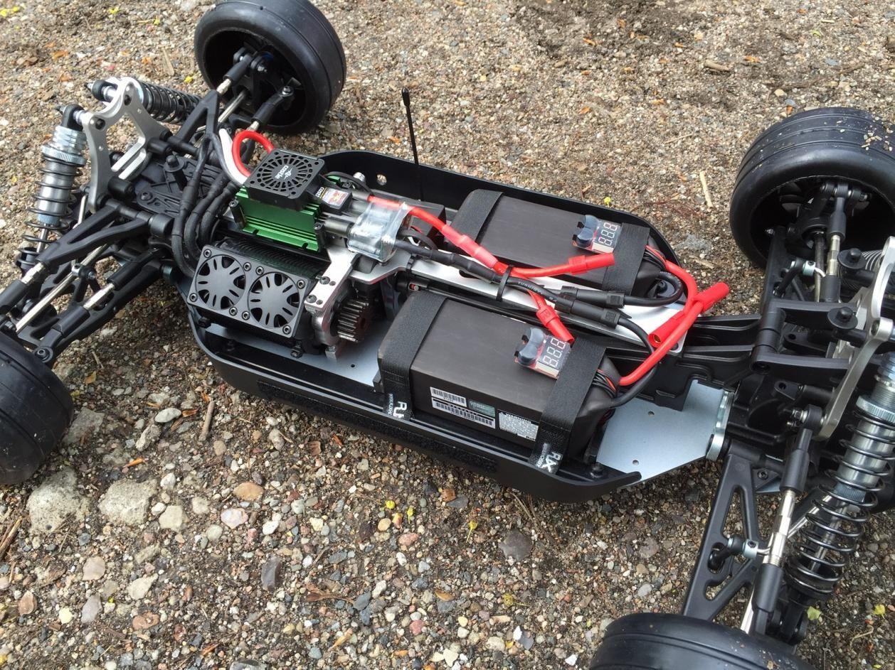

I have a couple of 5Ah 6S Turnigy Heavy Duty packs from my 1/8 scales, which I will start off with, running parallel (10Ah 6S total). For 8S I'll either be using 2x2 4Ah 4S (8Ah 8S total) Turnigy Heavy Duty packs, or the new Turnigy Graphene packs, when they become available and performance looks as good as the specs.

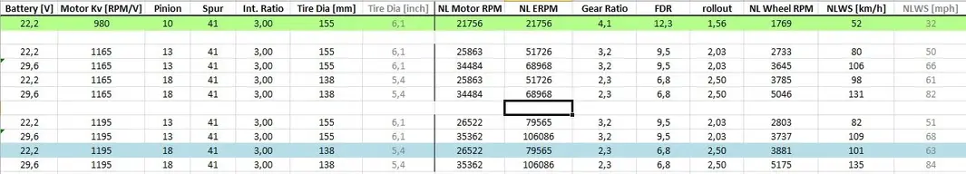

Gearing chart with resulting no-load nominal-Voltage (i.e., 3.7V/cell) wheel-speeds (NLWS) for measured kvs below. 13/41 on 155mm stock tires (80-109 km/h no-load, depending Voltage and motor) looks like good start for off-road, and 18/41 on 138mm GRP F1 tires (98-135 km/h no-load, depending on Voltage and motor) for on-road.

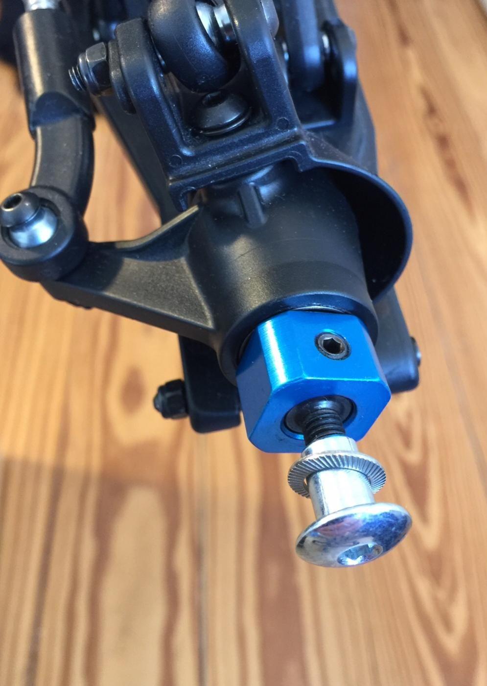

I like light and smaller wheels, so for now I'll stick to the stock and FG style tires, instead of going for the Baja 24mm hexes. Disadvantage of the FGs is they need some more modification with the new M10-stub axles (I still have a couple of M6-stub axles) and the off-set of FG style rims is way too big...

Gearing-chart, based on measured kvs:

No good... even with low-profile, washer-less screws: i.e., need big and heavy tires to gear up with mount in 2028/58110 position:
Winding-density comparison, LBP5811-950kv (left) vs TP5670 (right):

Mamba XLX form-factor works pretty well in this car. Buggy body still fits (just):

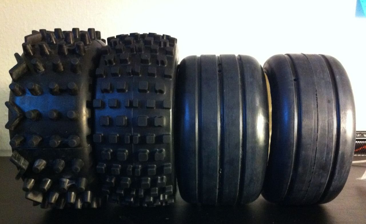

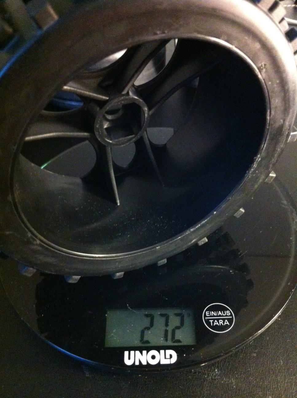

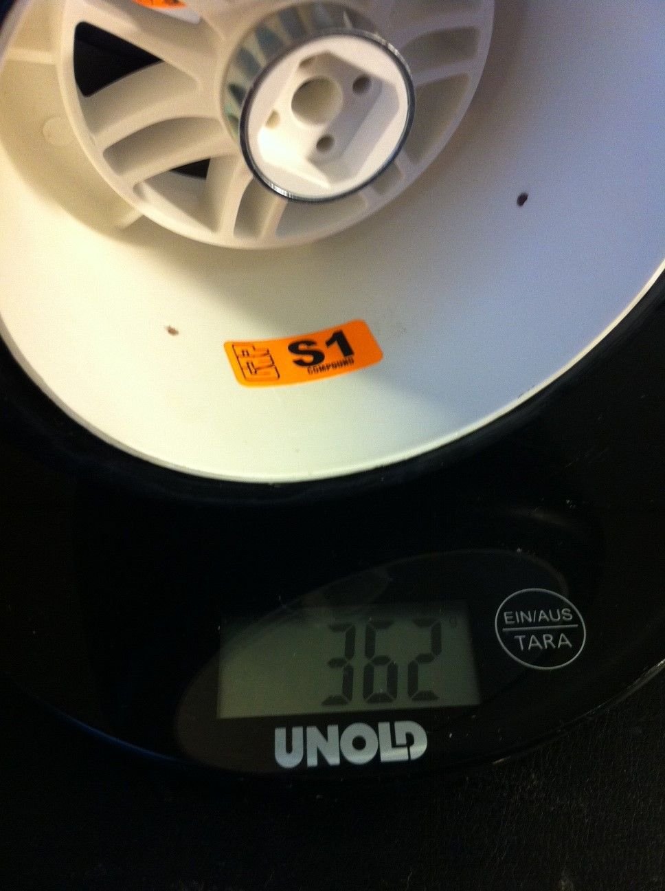

Tire comparison; left-to-right: generic FG off-road, stock, GRP F1 rear, GRP F1 front:

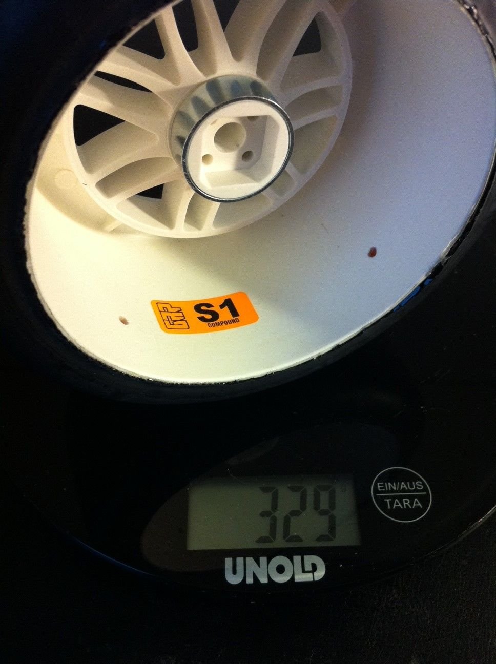

Rear GRP F1 tire weight:
Front GRP F1 tire weight:
Stock XB, Vader tire weight:
M6, 15x8x12mm Nutsert (Huelsenmuttern in German) with flanged washer to mount FG style wheels on the old M6 stub wheel-axles:

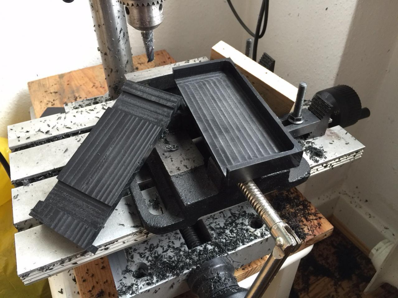

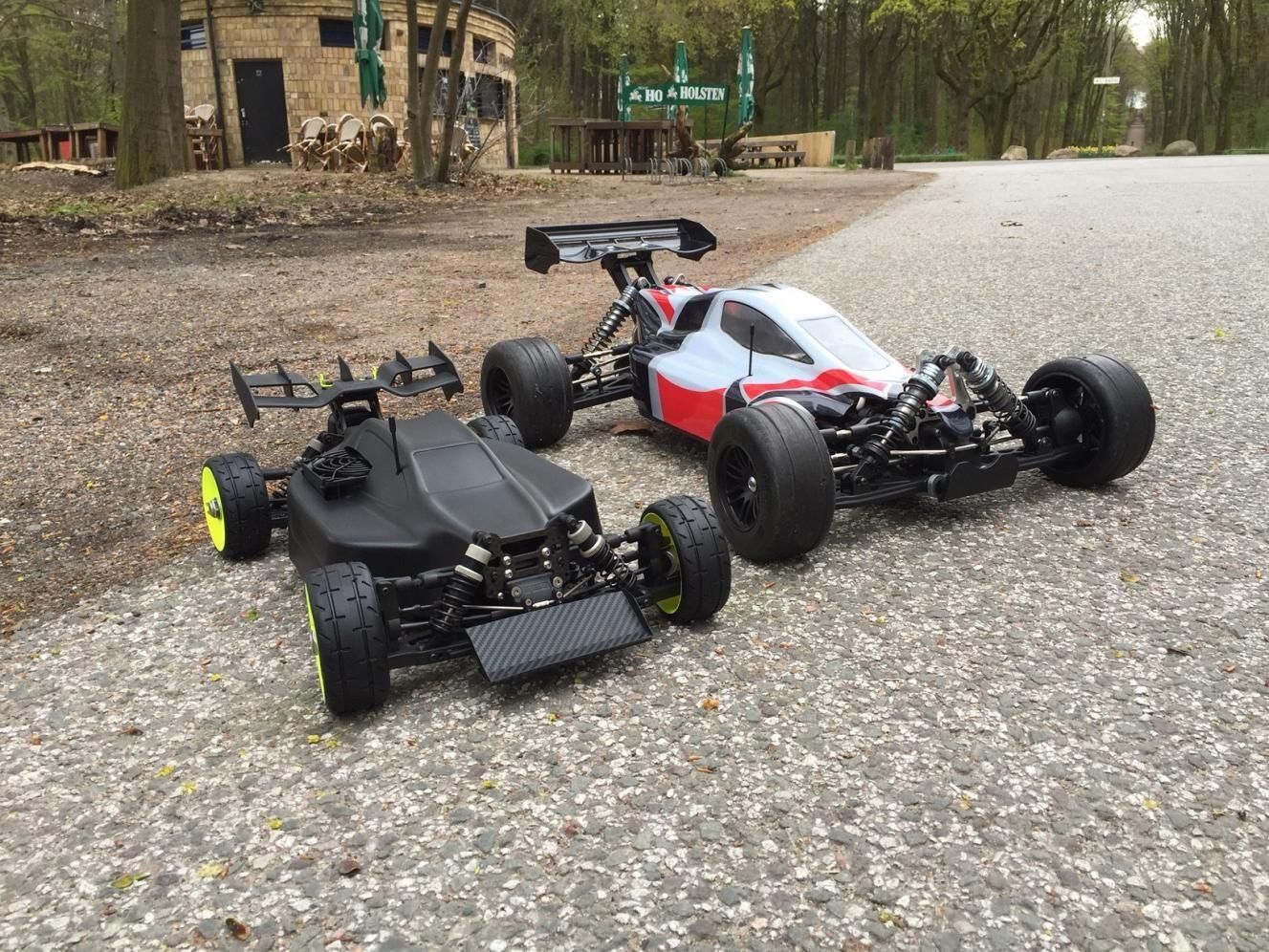

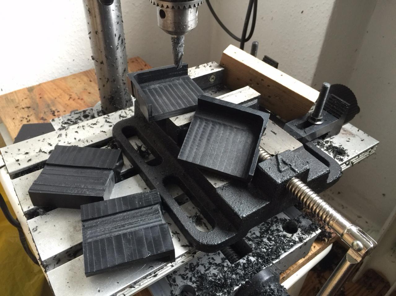

Making my own battery trays exactly how I wanted them took a bit longer than anticipated, but it's finally done! :)

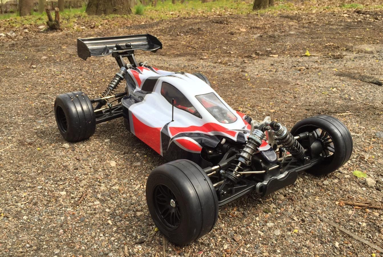

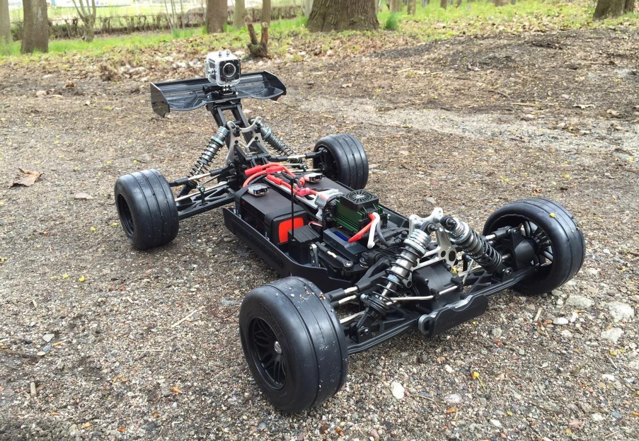

Did first test-drive on 6S, geared 18/41 on GRP F1 tires for 101 km/h (63 mph) no-load. Drove ok, it doesn't handle as well as the GT2 obviously, but this thing will be fun - the size makes it very impressive. Probably better suited for off-road than the on-road testing I did. Had to end test prematurely, because it seems I have another loose motor shaft on a TP56xx motor... To be continued...

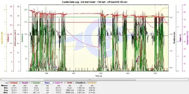

First drive with 2x4Ah 8S DIY Turnigy Heavy Duty lipos. 13/41 gearing for 106 km/h no-load wheel-speed. Drives pretty quick for a flashlight lawnmower! :D
Motor and ESC temps seemed ok, although ambient was only 13 deg C today. Also, motor temp is a bit hard to measure as I can't reach the motor can well with the tempgun. Rear end-bell measured ~60 deg C, but Leopards typically are a bit hollow at back, so on the can the temp would probably have been a bit higher.

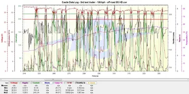

Log shows Current peaks of up to 250A with Current limit set to 220A. Average Current throughput is about 80-100A at the running parts. Ripple is nice and low. The 4Ah Turnigy HD cells do sag from 32.2V to 28.9V (.4V/cell) under ~240A load (120A per battery). Curious how the Graphenes would compare, but I need another set of 4Ah 4S packs for that, and they're currently out of stock... to be continued.
RPM data from log shows wheels were turning with about 95-105 km/h at full throttle.
Kershaw's pinion doesn't seem too happy after what actually only adds up to about 7 min of 8S driving.
Looking good, nice spread of power. That's a worry about the pinion though as I have just ordered one for my 8s set up.
Had poor luck with kershaw hardened pinions on steel spurs in my 1/8 scale stuff. Stay away.
Thank you for logging all of this, it's data that's missing from a 8s build!
Thanks guys! Yeah, too bad about the KD pinions, I actually bought 5 different sizes at same time to save on shipping to EU :D ...
Do you have any recommendations for good pinions? I also got 2 Castle Mod 1.5 pinions, but the grub screws in those are M4 with tiny 2 mm hex, while KD was M5/2.5 mm hex.
