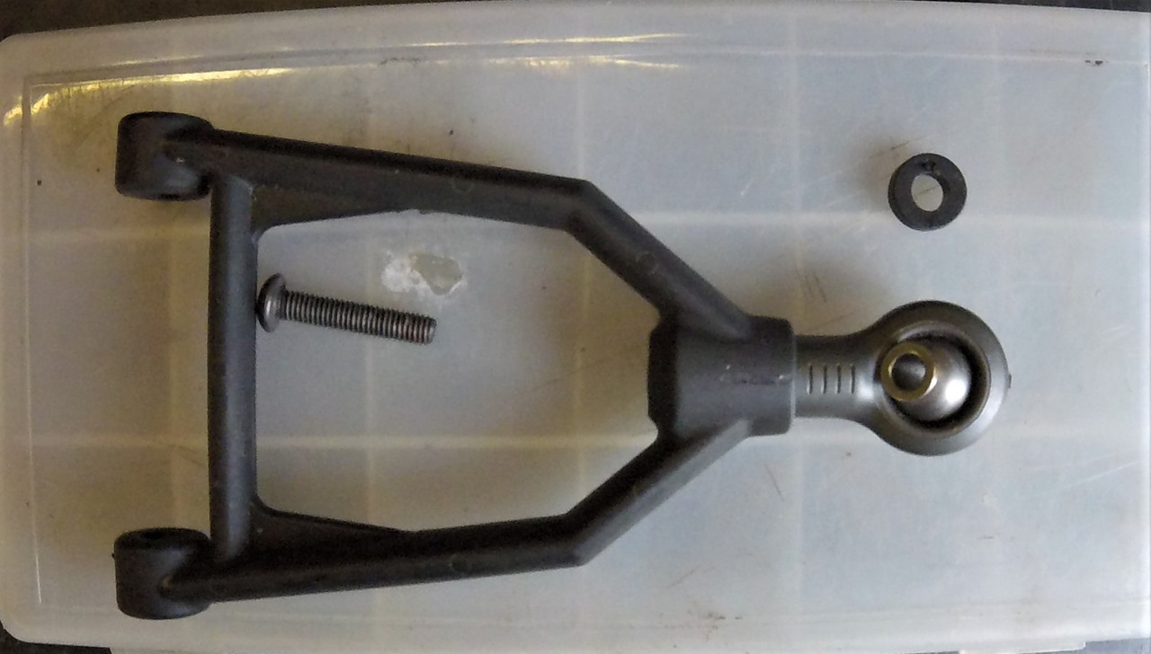

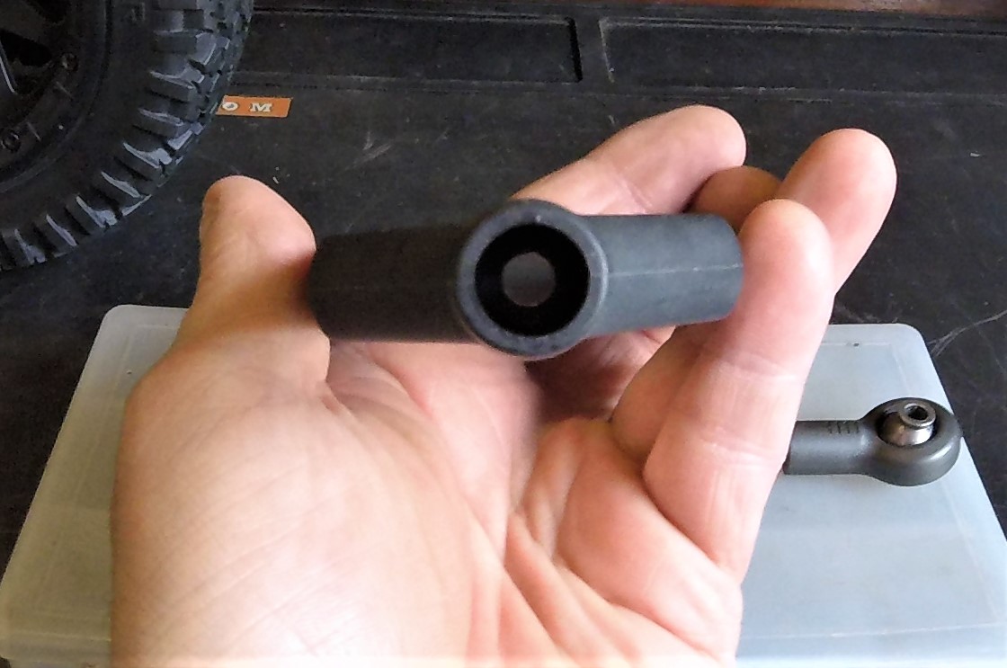

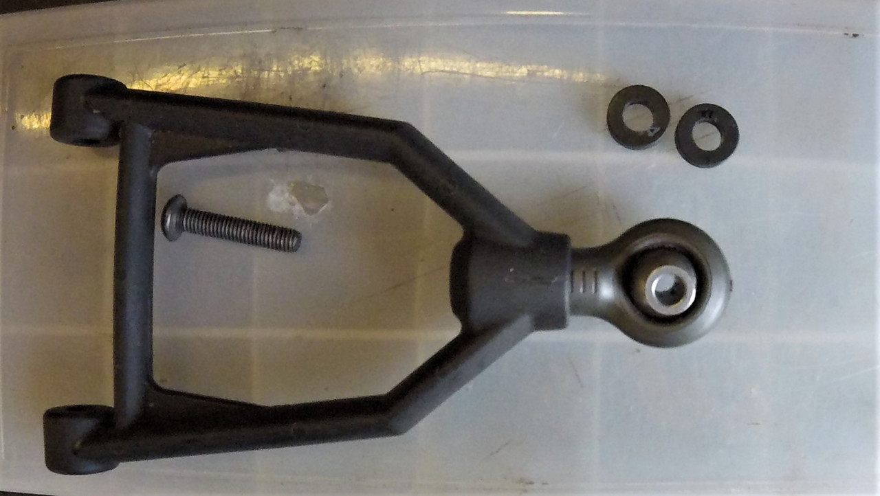

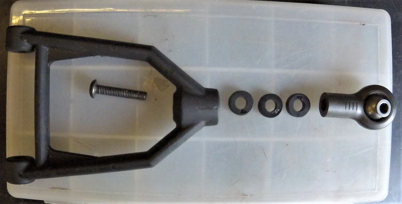

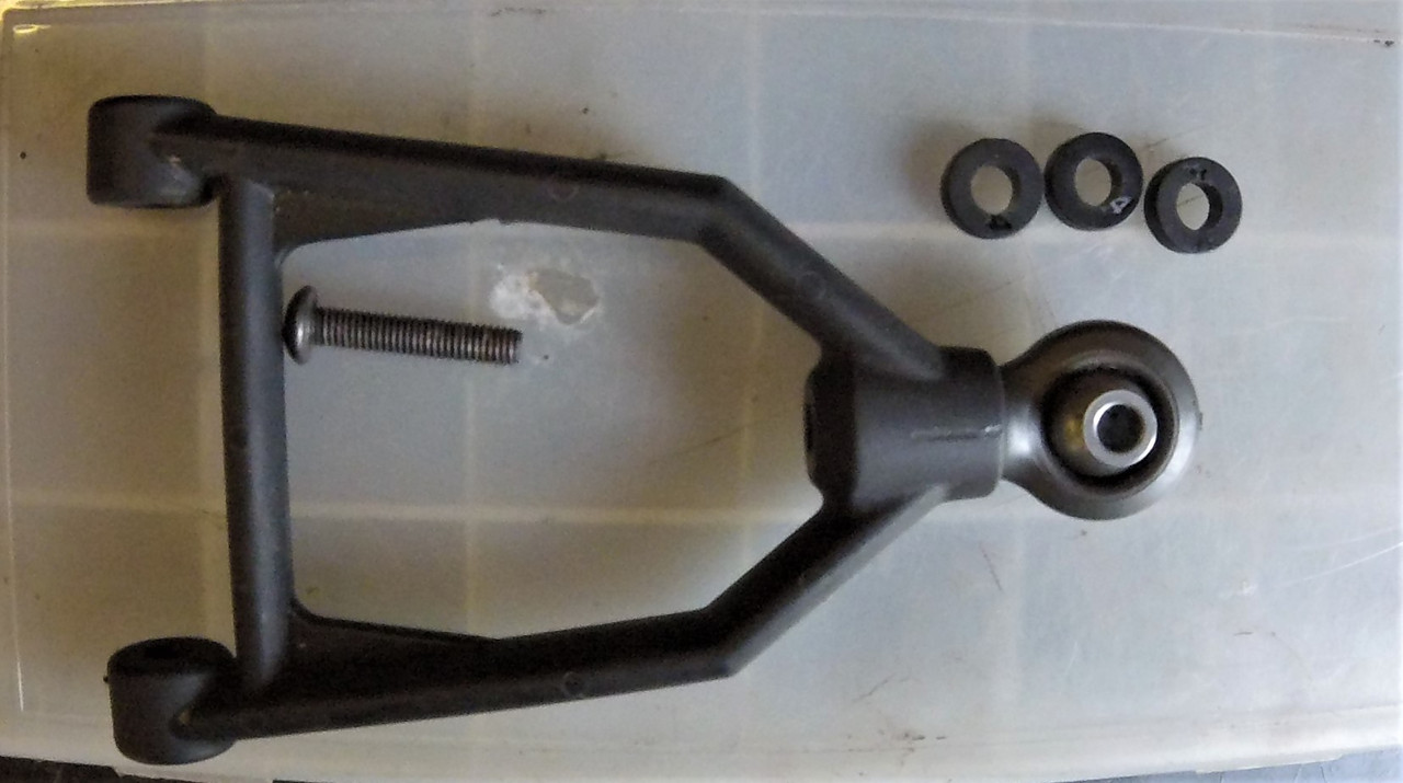

Are we talking about here between the ball joint and the top of the steering block. If not can you post a picture please.
right dude, the spacers go into the end of the upper front a arm in the hole and sandwich the heim against the inner part of the a arm to lock in all solid(y),
so spacers go in here,
spacers come in three thicknesses a thinner one thats equal to one mark on the heim and a thicker one thats equal to two marks then a third one thats equal to three marks on the heim,
then use a 1, 2 or 3 or a combination of them to get the camber you want (y)
i could only find the thicker ones in my parts but can explain it still :LOL:,
so basically you would have these parts for each front upper arm,
no spacers in the arms hole and heim sits like this,
one thick spacer brings the heim out to 3 lines,
so a number 1 spacer would bring it out to 1 line, a number 2 spacer would bring it out to 2 lines and so on,
two thick spacers bring the heim right out to here,
if i recall right hpi spacers are numbered on em 1, 2 and 3, rovan and km aint numbered,
spacers are needed so the heim can't push inwards under load and push the screw inwards on the arm,
hope this makes sense mate (y):LOL:
