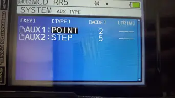

Anyone having problems setting up Sanwa MT-S with KillerRc killswitch? i have got it to work so i can turn off the engine with SW2, but killswitch wont reset, need to turn off and on the car before i can start the engine again :)
AUX1 to SW2 and "point", "Step" does not work? odd stuff lol
