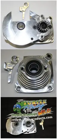

well thats not completely covered there will be a gap between the holder and that engine mount, i would be more concerned with your air intake and the carb base and mainfold gaskets, make sure those are sealed and you wont get any sand in the engine,also get yourself some outer wares for the air filter and the pullstart and seal the bottom air intake of the engine,try to keep as much sand out of vital parts as much as possible
Outerwares are on the way Thank for the info. As for the clutch cover i don't need it right now, i just figured since i had some cash.
