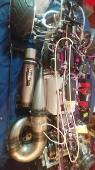

Getting There!.
It only took 13 days to get in the new brake parts?
Have a bit more to do:
Put in washers for servo saver- oops.
Connect Exhaust
Change hydraulic brake elbows
Fill brake reservoirs.
Rerun/design throttle linkage
More cable/wire routing..
And since I keep changing my mind- who knows??
Thinking of coloring chassis brace.
Not done so .....?

Looks good
Lots of lines,it'll get cleaned up. Nothing is in place because I have to take it apart again,I forgot to put in washers for the servo saver?‍♂️.
So still toying with placements of stuff for cleaner look. Picture was taken a little off on purpose.
When finished proper pics will be taken.?
