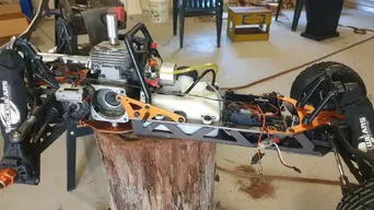

Change the carby, if not then tear into erSo I killed it?ā?ā?
Let me list what iv done to it to get it going?
1 new plug
2 new coil
3 new carb gaskets
4 new isolator block
5 coil gapped with BC x2
6 Eliminated kill switch
7 new motor button
8 checked for leaks on the seals
9 check head bolts (2 on the carbs side half turn lose??ā)
So I rekon i have ticked all the ?ā boxes. It still has compression not great but still has the only thing I can put it down to is the 1107 is feked (excessive wear on the throttle shaft or head gasket is done....or both??āView attachment 64989
View attachment 64990View attachment 64991View attachment 64992View attachment 64993View attachment 64994
Stumped ?ā
