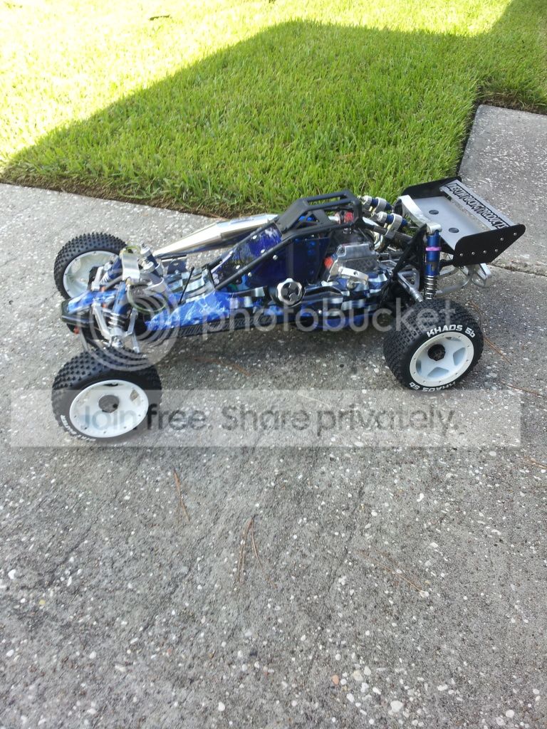

i still take very good care of that rig, but it damn sure aint no shelf queen, just about every part on the car is aftermarket, it looks good , but it is/was built to take a beating and test parts to thier limits.
i have broken and bent chassis, shocks, control arms, destroyed bodies, blown out tires, broken wheels, completly destroyed driveline componets, including aftermarket parts.
as it sits right now it has been tortured, and knock on wood , i have not broken anything major the last few times it has been out, i think i finally have it close to the point of bullet proof...

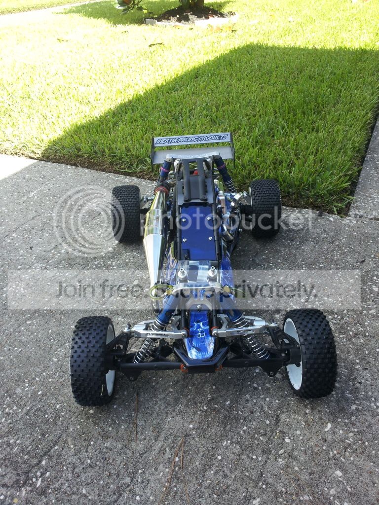

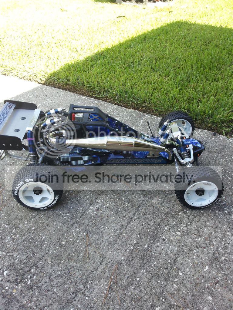

here are a few pics of the test rig. it is just a little over 2 years old and has had the ever loving snot beat out of it.
the tires and wheels are new in these pics, i will be bashing on them in the comming months.

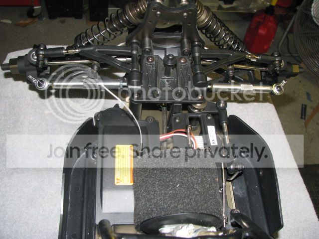

i got the front end all buttoned up. ( for now )

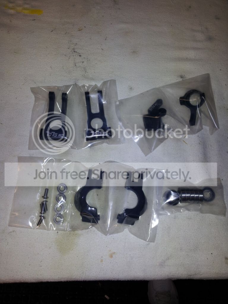

installed the new 7075RC c-hubs and bearing holders/steering arms. i must say i am very impressed with Doug's work.
the parts look great and fitment is spot on.
i was particularily impressed with the improvements on the c-hubs over the stock set up, the bearings were a much needed component.
the installation was a breeze with zero issues.

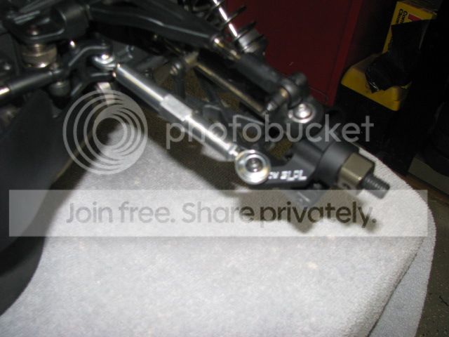

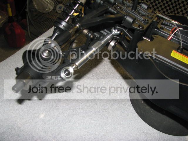

as you can see i also took the liberty of fitting up a set of my V2 tie rods.
these were made up special for this build during the wee hours of the night after i was supposedly finished working... they came out great and fitment is spot on with no loss of articulation .
the 1/2" tube may be a bit overkill ,but what the hell, thats what i had laying around the shop.
i will get to work on the rear suspension as soon as i can, i also picked up all new servos from the DDM Black Friday Sale Hitec 5765 and 5645, i also grabbed a few other goodies while i was there..Lol
here are a few pics of the front end
