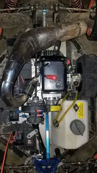

That Snapper is on the 5ive T...I was taking the truck apart cause the truck needed some cleaning
....since i was stripping the truck down anyway...why not open it up to take a look. I noticed some blueing on the disks the last time I had it open.
I have the Turtle Racing clutch carrier on that truck.
For the disks on the clutch to be that dark....there had to be alot of heat generated inside the clutch housing. I'm going switch to an open carrier, maybe the stock 5ive B one and upgrade to the carbon fiber disks for the snapper...that SHOULD take care of the heat issues.

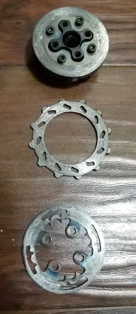

It only takes 8 screws total and the clutch is apart.
Top 4 screws out and you can remove the first 2 disks..

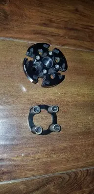

Remove the last 4 screws and you expose/access the basket and weights.

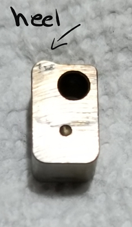

The weights are kept in place on the basket with a dowel pin.
There is a small "heel" on one side of the weight. Heel should be on the outsde of the clutch.
Last part of the clutch are the springs and spring perch. Remove the basket in order to access them.
